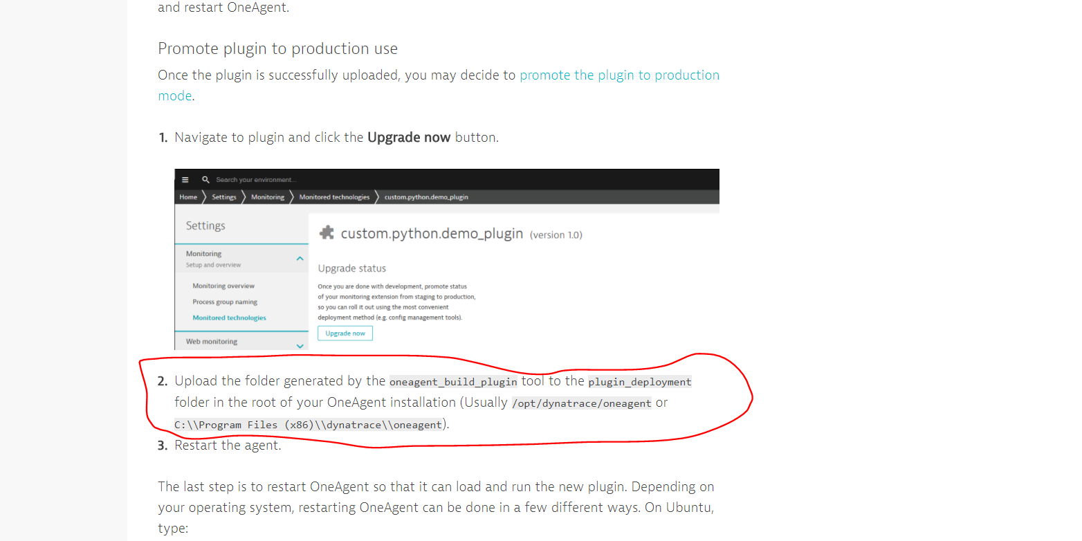

I'm attempting to create a custom plugin and when I review the logs I see the following in the stacktrace which I'm assuming to be the issue because of the path being with the slashes incorrect. I've searched around and I can't seem to identify where the path is being set for the agent. Any help would be greatly appreciated.
pgi = self.find_single_process_group(pgi_name(\'runmqlsr\'))\n File "C:/Program Files (x86)/dynatrace/oneagent/agent/plugin/engine\\ruxit\\api\\base_plugin.py"

From the documentation i see the following info below
See full doc here
Hope This Helps
NJ

Hi NJ. Thank you for your reply. I did notice that as well but I can't find where in the python code it is generating this path from. I'm assuming it is with the oneagent_build_plugin but I don't know how to change the path.
