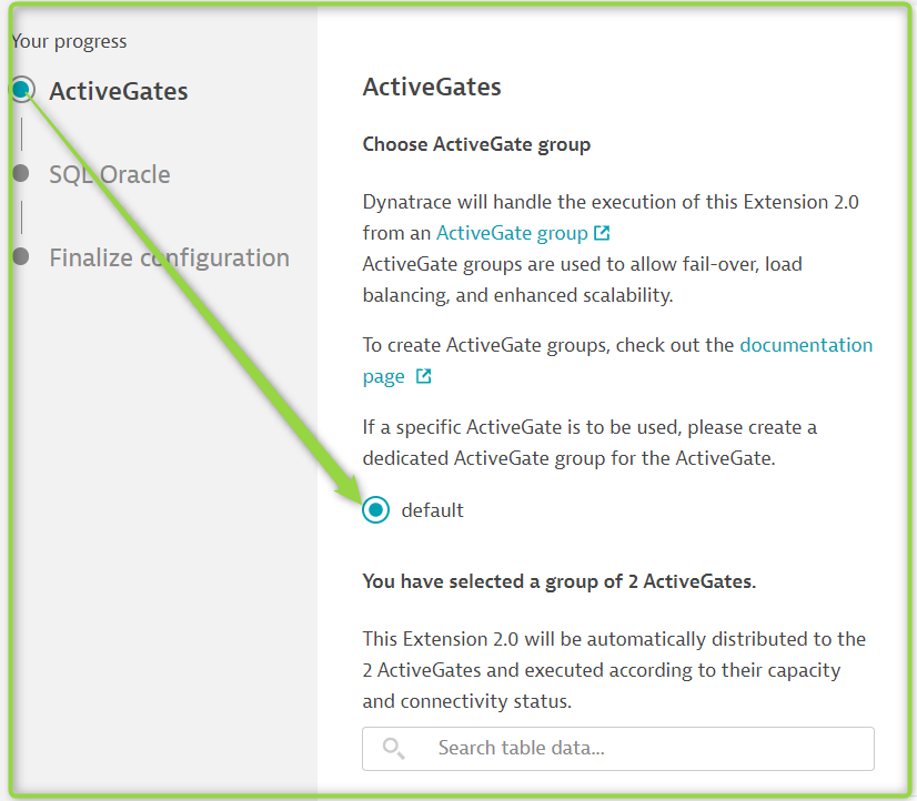

Thanks for raising these points, we have already exposed such scenario where :
  • We had AG group containing the installed AGs to run extensions.
  • These AGs were intended for Oracle DBs monitoring.

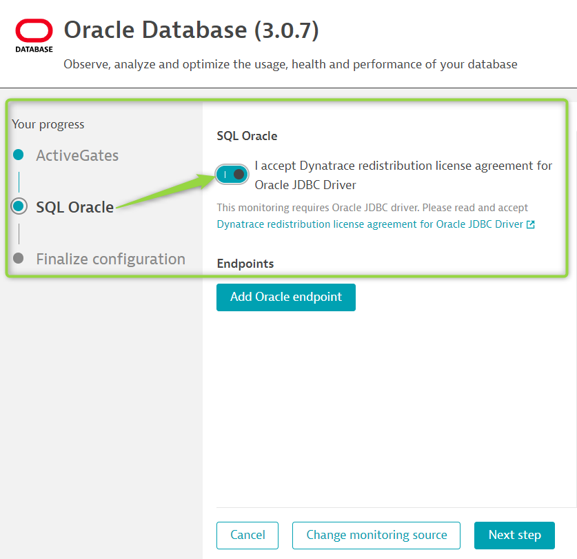

  • Once you add the extension to the target monitoring tenant > Select the Ag Group > accept Dynatrace redistribution license agreement for Oracle JDBC Driver.

  • While having the oracle DB extension installed on 2 or more AGs in AG group at least you will be able to configure a dedicated Oracle dashboard containing 85 - 90 metrics to show the deepest level of insights to Oracle DB team.

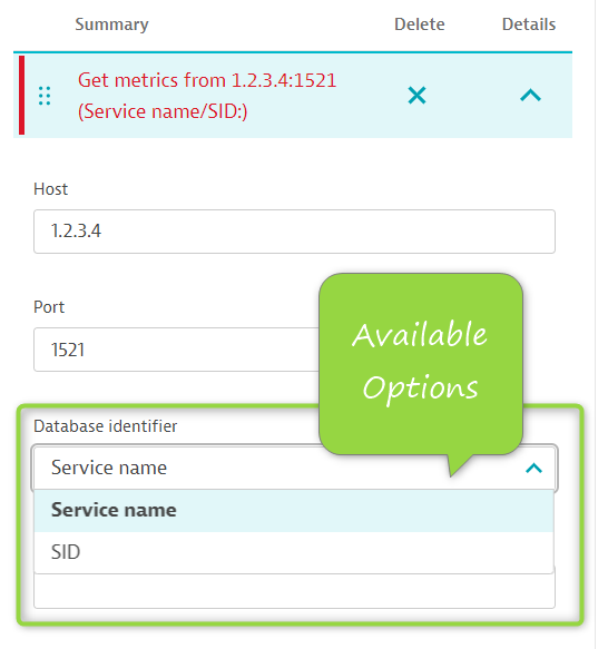

Mainly the communications between the AGs and the Oracle DB instances should be conducted properly on port 1521.

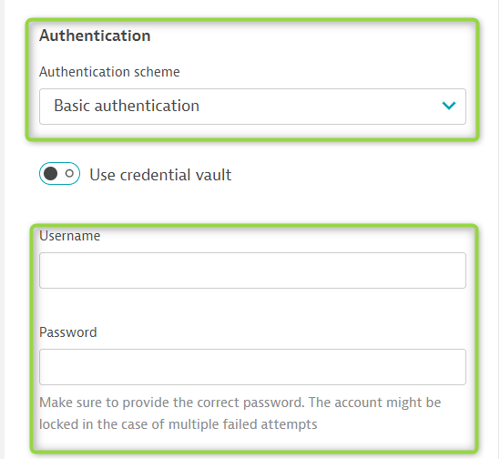

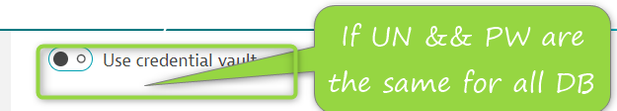

You can either configure it through:
  • User name and Password.
  • Connection string.
