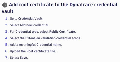

22 Aug 2024 03:15 AM
How about step 3? Have you done the following steps:
22 Aug 2024 06:52 PM - edited 22 Aug 2024 07:55 PM
I found the credential vault and uploaded the root file.

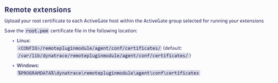

Please run the following step afterward:
If you installed the activegate in your PC, you may simply copy root.pem into the specified directory above.
26 Aug 2024 05:43 PM
My ActiveGate is AWS and I copied the root.pem file to the path.
I'm still getting this error "[SSL: CERTIFICATE_VERIFY_FAILED] certificate verify failed: unable to get local issuer certificate (_ssl.c:1000)"

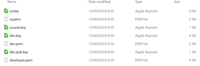

There are several .pem files in your secrets directory like this:
Are you sure you copy the 2 KB file? Also which file did you upload to the credential vault? Screen shot may help us to identify your fault

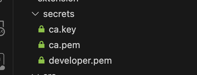

27 Aug 2024 06:19 AM
These are the files in my secrets directory.
I uploaded the ca.pem file to the credential vault from the UI
I added the ca.pem file to the Activegate host

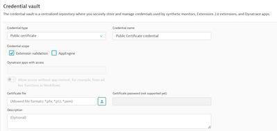

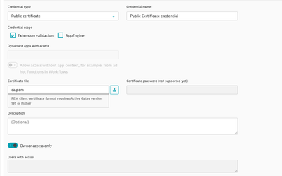

28 Aug 2024 03:18 AM
Please reupload the certificate into credential vault and give us the screen shot like this one:
Fill the description with your name to check whether it has successfully shown up in the credential vault list
29 Aug 2024 03:31 AM
Please input a description and save it. The description should show up in the credential vault list in the name & description column along with your email address in the Owner column.
