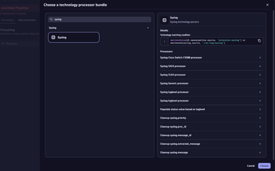

Also, we have come up with some default log processors now that saves you from creating the rules. Goto openpipeline -> +pipeline -> select processor under 'technology bundle' and see below options
