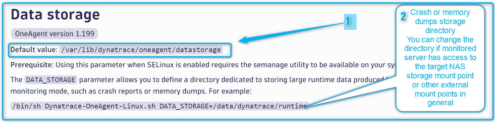

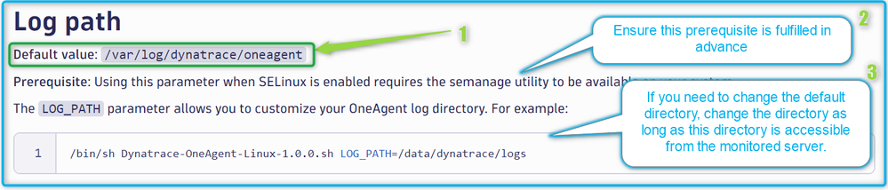

  1. The installed oneagent will have all directories stored locally as long as the server isn't connected to external NAS storage.
  2. If you need for example to mount your installation or log directory to external mount point you have to ensure that this directory is accessible from the server, as if you're configuring cluster backup..
  3. As per the attached example you can check if it this fits for your case or not.
