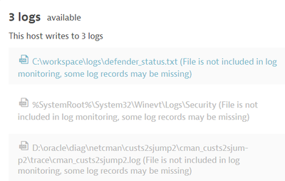

I have added a custom log source for one host where I am testing some script which makes a log file. The file is present on a server however in Dynatrace view of the host it says "File is not included in log monitoring".
Why is it not included when I have defined this as a custom log source?
I have tried making this again in settings / log monitoring / Custom log source configuration but there is no change. I don't see this log source in Observe and explore / logs and if I click on it in the host page down it says No data that matches your query.

That's where I have looked and that's how I have done it according "To configure custom log sources at the host level", so not sure what's missing or where is the problem.
McVitas
Participant
OK so I figured that Log storage configuration must be enabled. I thought this is not related, but when I have put there a source based rule to include this file to be stored in Dynatrace suddenly it stopped saying File is not included in log monitoring, I can click on it from host view and I see the content.
