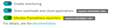

If this is in Kubernetes you can set up the Kubernetes integration and there is a new feature to have it scrape your metrics endpoints if you annotate them with the required entries. This brings those metrics into Dynatrace.
https://www.dynatrace.com/support/help/technology-support/cloud-platforms/kubernetes/monitoring/moni...
