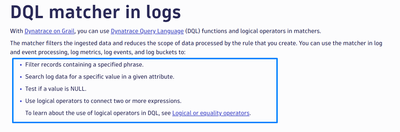

I suggest adding a unique log value for the entity (like the Project ID you're already using) to make it more maintainable over time and easier to understand.
Then continue with what the documentation indicates that it can be done.
More Info : https://docs.dynatrace.com/docs/shortlink/lma-log-processing-matcher
