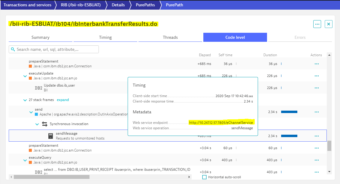

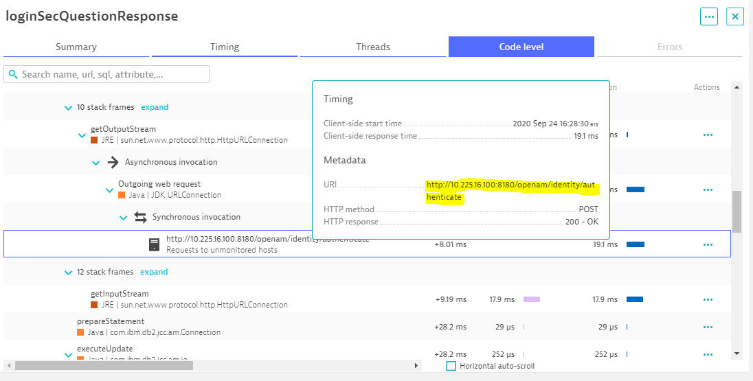

I want to make request naming rule to split a request to be new request
Here is a request named "/bii-rib-ESBUAT/ib104/iibInterrbankTransferResults.do", but I want to split this request when calling web service eChannelService like in below capture
Is it possibe to create this one ? I try to explore, but I don't see any option to create condition like this

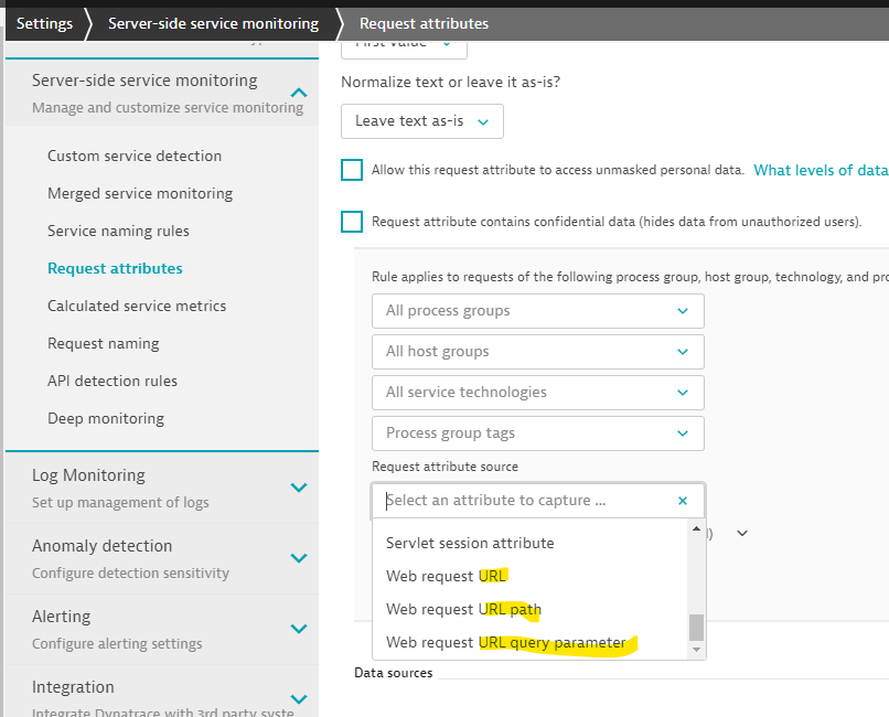

Hi @Muhammad N.
In order to create RA with web service end point you can use one of the Web Request URL attribute source.

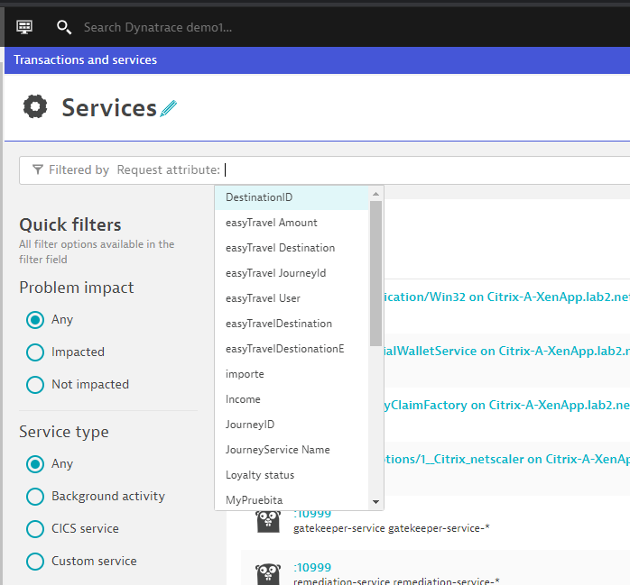

After you will crate the RA you can search the RA from the services filter and see the service that "catch" the RA setting, usually its take 2-4 minutes till you see data.
Once you get into a service that do show your RA you will see under dynamic web request a new tab for RA and if you will expend it from the right arrow you will see the different values.

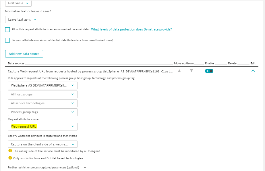

Hi @Yos N.
I try create a request attribute with source Web Request URL, below is my request attribute setting
But in the result, this request attribute capture from web request url from this own service, not the called web request/service

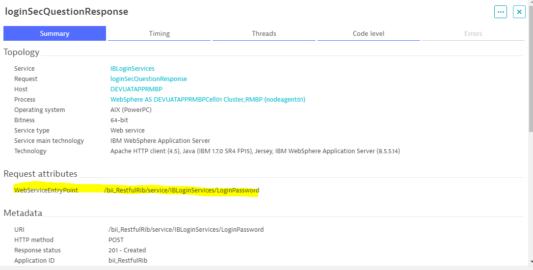

How I expected the result is to capture a particular called web request/service in this request
I want to capture this
Can you help me how to configure it ?
