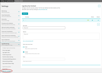

Hi @erh_inetum yes, by default, Grail uses the management zones to set the dt.security_context on most entities. But for logs or bizevents you can do this using OpenPipeline or security context menu for logs.

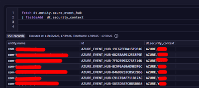

Hi @erh_inetum
To supplement the answer of @DanielS 💪

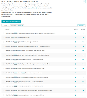

Currently Dynatrace configure all entities in the securiy_context the same value that it's ManagementZone
Settings/Topology model / Grail security context for monitored entities
Example: Azure
So, if you search about some of that entities:
Example :
dt.entity.azure_event_hub
You will find a information of your MZ in the Security_context.
