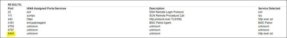

What is the impact of closing this port ? knowing that we install Dynatrace recently and get a message from Security team
We performed VA rescan for the Dynatrace servers, still the port was open ,still the vulnerability” Multiple Cross-Site Scripting Vulnerabilities Detected” detected.
Please advise.
