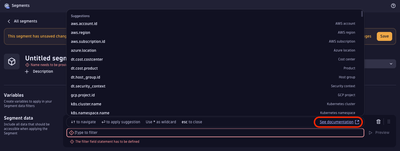

When I am trying to build a segment, I saw the link to documentation as shown in screenshot
The link points to the page https://docs.dynatrace.com/docs/discover-dynatrace/get-started/dynatrace-ui/ui-filter-field
So this is kind of confusing as the documentation link mentions the operator 'in'.
