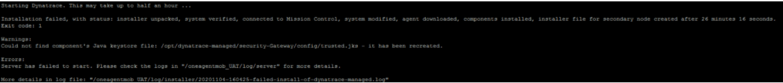

Hello everyone,
I am trying to install Dynatrace managed cluster node but getting the below error
Need help

I'm not sure if the attached log file is from /oneagentmob_UAT/log/server, as the error suggests.
But this looks like something to look at:
Redirecting to /bin/systemctl start dynatrace-server.service
Job for dynatrace-server.service failed because the control process exited with error code. See "systemctl status dynatrace-server.service" and "journalctl -xe" for details.
Timeout of 900 seconds was exceeded
2020-11-04 11:00:42 UTC Executing command ... failed after 15m 15s, with exitcode 124
Can you check the output of systemctl status dynatrace-server.service and journalctl -xe?
Those might have more details about why dynatrace-server is failing to start.
