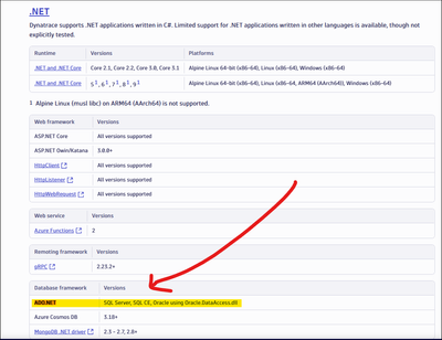

Regarding 2, could you please provide the link where you get that table?
The windows service that is beinf deep monitored was build tartgeting .NET Framework v4.8, and is using vanilla ADO.NET to communicate with the database.
When hosting a service in IIS, targeting the same .NET framework, and using ADO.NET, we can see the statements being collected. In case of the windows service, we cannot. So, there's something here that I might be missing.
I have just edited my before comment because table was not correct. ADO.NET is supported, you can see it here
