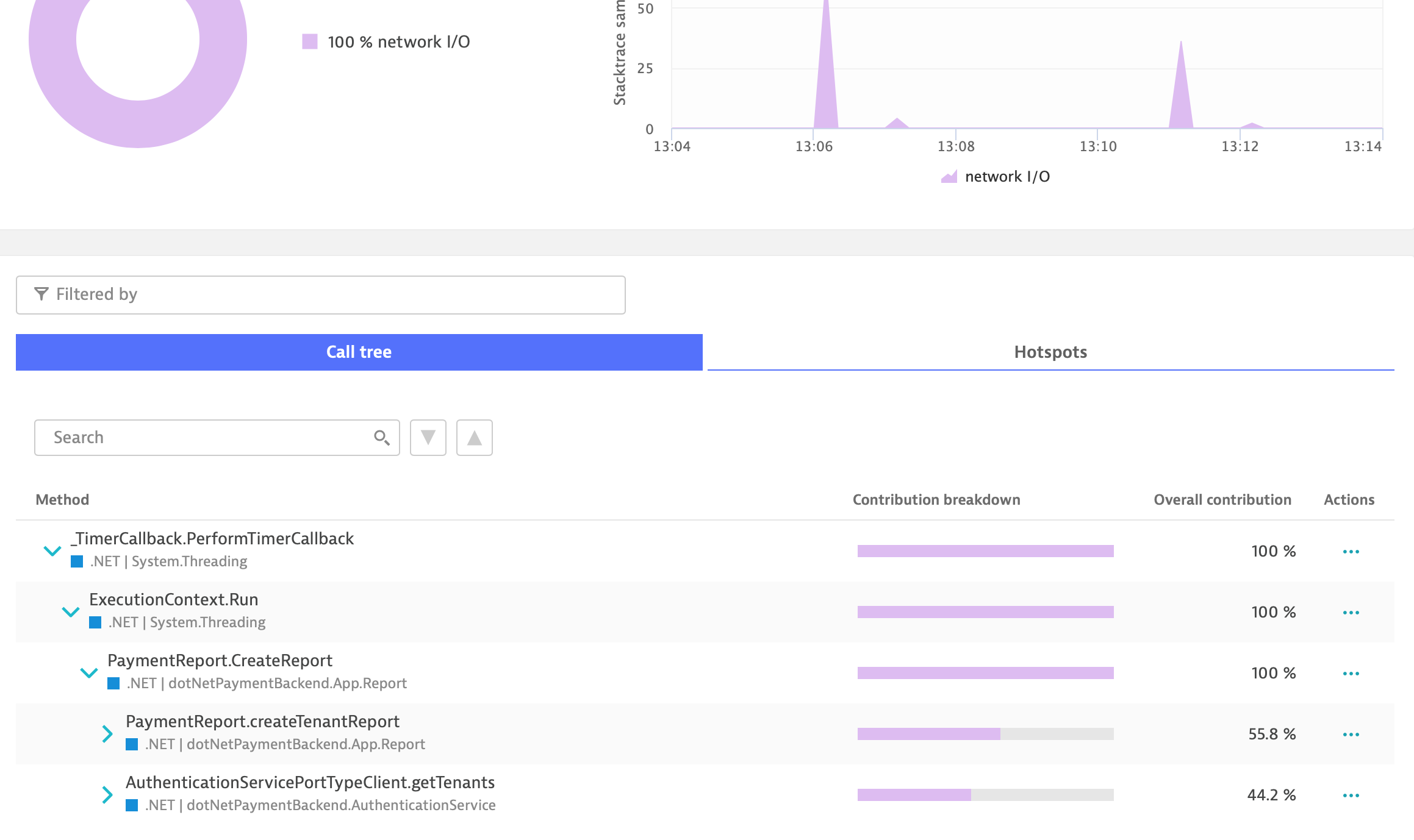

The issue is that, there are executions of your internal code methods. In such case you may not see them on purepath without putting extra sensors using Request Attributes. To investigate it, pick some sort of purepaths that mathes the same patterns (ex. url + response time X s +) ans then drill down into method hotpots. You will see what part of your code keeps more time on CPU and what less.
If you will find method that may bee root cause create Request attribute based on .NET Method:
https://www.dynatrace.com/support/help/how-to-use-dynatrace/services-and-transactions/configuration/...
Restart your process and you will see it on purepath. You can make on top of it custom service as well if this will be better for you.

Did you check method hotspots for larger amount of purepaths? In general, for .NET core it may be somwhere issue with collecting full purepaths without adding extra request attributes or custom services. For example there is only MQ communication inside, which sometime may not be correctly monitored out of the box. In such cases you need helpt DT to see full transaction.
