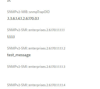

but when I sent a trap for testing, in Dynatrace logs I see the snmp varbind OID :
and not the OID Name as reported in the mib file (alertID, type, severity, ...):
did I missed something?

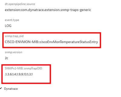

The SNMPv2-MIB::snmpTrapOID that you show will always be in number format.
The complete name of the trap OID is named snmp.trap_oid, and should appear slightly above, as in the example below (for another type of trap). I have a very big use case of traps, ~100 custom MIBs, and it has worked flawlessly with me.
