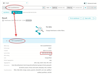

One thing I wonder is if this applies to accessing the metrics via Data Explorer?
Yes, this also applies. Here you can see a metric I don't have permissions for, which contains data because the last field entered is in the same time interval as the query, but the query doesn't return anything.
