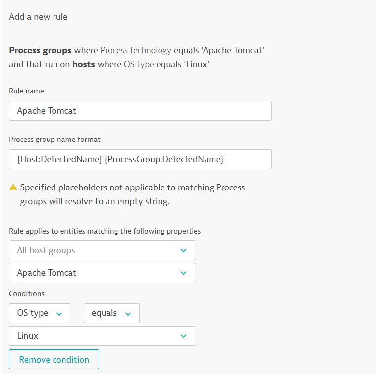

Is it possible to show the hostname in a Process name? All of these Apache-Tomcat have identical names and I want to distinguish them by using the Hostname, so that it will be visible in the legend of a custom chart.
This is the process group naming rule I’ve come up with, but it doesn’t have the right output.
Now I get the hostnames of all 3 hosts in front of the process name.
How can I get this right? Is this even possible?

Hi Sten,
Unfortunately this approach will not work due to the structure of the process group within Dynatrace. Since we can have multiple processes across hosts that are logically constructed into a group, naming rules apply to the group specifically and not just the process group instance.
That's why you would be seeing this behavior. There are a few different ways that you would be able to see which host the process is associated with throughout various views in Dynatrace so the naming rule may not be the best place to surface this information.
Thanks!
-Dan
You can't get that from there. Those rules update the process group name not the individual instances which is why it will include the properties from all of the instances.
You can't just modify the names for individual ones because they are just part of that group. All views where you'd see all the instances together would call out the host they are on regardless.
I'm not aware of any screens where we'd show all of the individual instances of the process group without also showing that. Now if the case is that there are multiple process groups that all have the same name then you could use these rules but you'd have to use something that is consistent across all of the instances to avoid having a set of values used. You can look at some of the process properties like command line args to see if anything you can use. You can use regex to extract things:
https://www.dynatrace.com/support/help/shortlink/process-group-naming#define-a-new-process-group-nam...

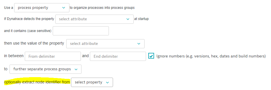

If you absolutely needed some differentiator in each of the instances you'd be looking at a process group detection rule. I believe extracting the identifier for the process group and picking a node identifier would be the approach. This requires restarts.
https://www.dynatrace.com/support/help/how-to-use-dynatrace/process-groups/configuration/adapt-the-c...
That would result in some identifier showing in parentheses next to the group name per instance.
