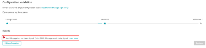

Can you help? Our SSO configuration is stuck at "Validation" step.
There is message on configuration page "SAML response and assertion is signed/unsigned?"
How do I check if Entire SAML message is signed or nor? I have SAML tracer extension installed. I need to go back to Idp admin and show them an evidence that, SAML message received from Idp is not signed completely. I'm assuming here, the SAML message received from Idp is not fully signed and dynatrace not is showing the above message.

you need to check if there is a <ds:Signature> element right under <samlp:Response> element.
If not, it means, that the whole Response (whole SAML message) is not signed.
Please note, that if a <ds:Signature> element is only under <saml:Assertion>, then only assertion is signed which is not enough for Dynatrace SSO.

@AK, yes, in the screenshot <ds:Signature> element is under assertion which is wrong - that means that the customer IDP is set to sign only assertions.
Dynatrace SSO requires that the whole message (<samlp:Response>) is signed.

You were right. Response (whole SAML message) is not signed. Validation was successful, after enabling the signature for response as well.
