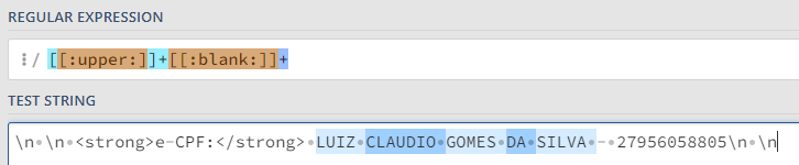

Hi @natanael_mendes, assuming that name is a placeholder. You can use:
/[[:upper:]]+[[:blank:]]+/gm

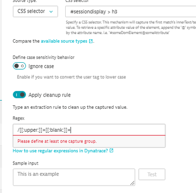

Im getting this

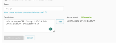

you can also use the following for user tagging regex cleanup rule

i tried this too
The sample that i have is this
\n \n <strong>e-CPF:</strong> LUIZ CLAUDIO GOMES DA SILVA - 27\n \n
I've tested it and it works with the sample you've provided, you need to add "space" after ">"
Certified Dynatrace Professional | Certified Dynatrace Services Delivery - Observability & CloudOps | Dynatrace Partner - yourcompass.ca
i used your code to do what i wanted, was not the solution for real but was very very helpful. thanks alot

I tried but the Dynatrace Regex is different from others
