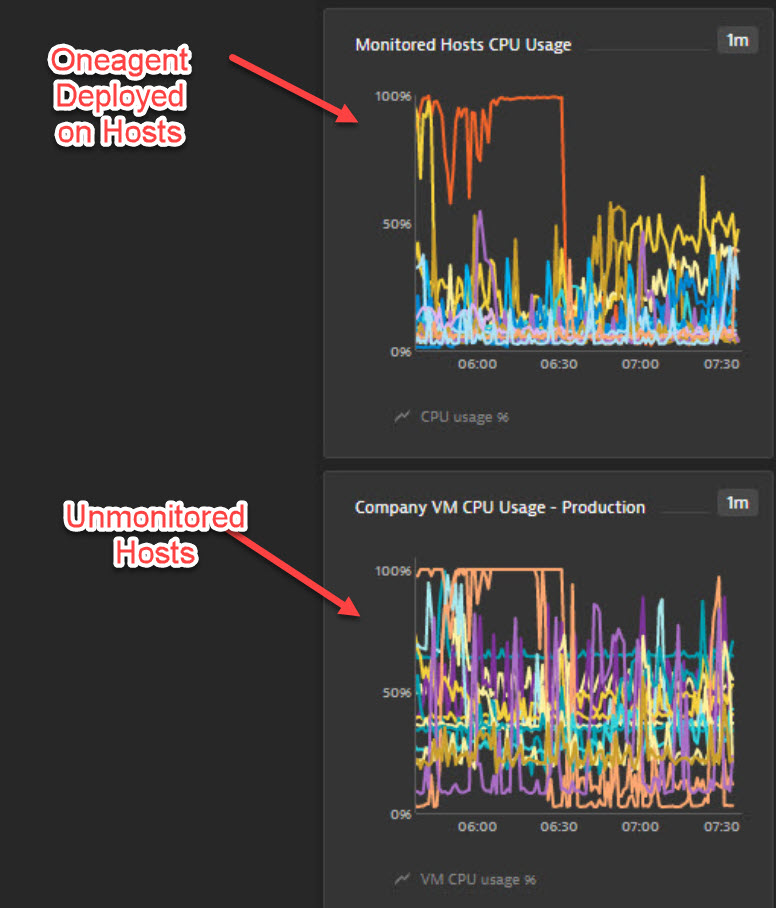

Another thing to note is that while you might be deployed to 50 some odd hosts as full stack, those hosts communicate to other hosts that might not have the oneagent on them. this communication allows you to see a basic set of information at that unmonitored host level. If you also supply credentials to Vmware or other cloud platforms, you will be able to create custom graphs but wont have the full alerting capabilities as having the oneagent installed.
