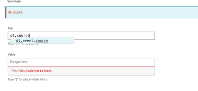

but when I go to add a dimension I don't have the option to do dt.source_entity or dt.source.entity
closest thing is dt.event.source but I've tried using it to no avail

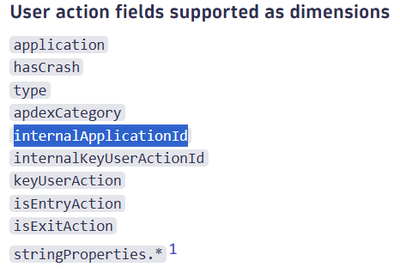

Could you check where that WEB application metric is set? It's probably and dimension on the metric. There is a value available called: internalApplicationId in the user action properties:
If you look in the data explorer you can find it. Than you can just refer to dt.source_entity in the metric event (it works, no worries).
as you can see this correlates! 🙂
#Performance matter!
Thank you so much @michiel_otten !! this will definitely work. I see now looking at the metric we don't have internalApplicationId as a dimension. I will work to put internalApplicationId as a dimension across our metrics and add the key value in the metric event. Can't thank you enough!
