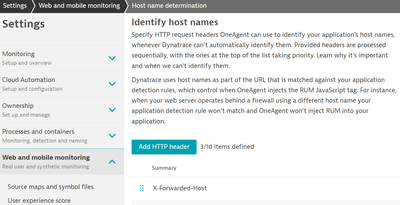

Found more info, there are options in dynatrace to use information in "request headers" to modify the Hostname and/or IP from the source:

If JS agent can't define application URL - in this case JS agent will try to find value in:
X-Host, X-Forwarded-Host, YOUR-TEAM-CUSTOM-HEADER
If JS agent can define without this headers - rules will work - so application detection rule for original host/domain - will work. If can't - and headers were added - again will work rule that contain original "host/domain".
We faced this when HTTP2 is using - there is no header "host" in this case. You can check - if you will see in DevTools something like this in request headers ( :authority: )
One case was to ask Customer don't block request header origin \ request header - host. After this JS agent in our case define application URL correclty without additional headers.
Another case was to ask put correct info in X-Host, X-Forwarded-Host. Also rules works that contain original "host/domain".
