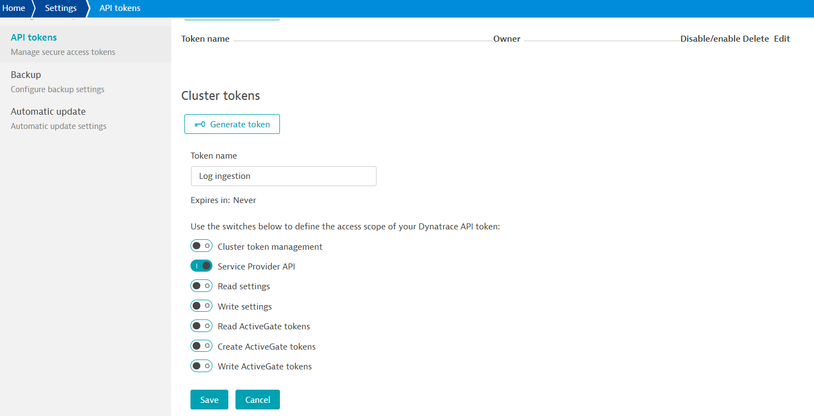

Via Dynatrace cluster API v2, Dynatrace admin or SRE team can increase the limit of ingested logs into Dynatrace.
  • Create token with "ServiceProviderAPI" scope and keep it in safe repo for future usage.

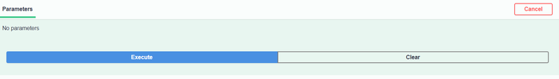

  • User menu > Cluster API v2 > Logs > Post
  • Unlock using the access token >Specify the max log ingest limit as per cluster node resources >Execute.

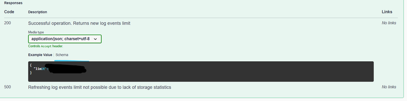

  • Download the Json file after getting "Response: 200"
