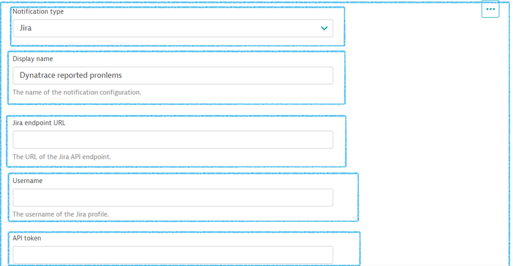

On Dynatrace side
  • The below highlighted parameters are mandatory.
  • Display name can be customized as per preference.
  • The remaining parameters are provided by Jira team: Jira endpoint URL, Username, and API Token.

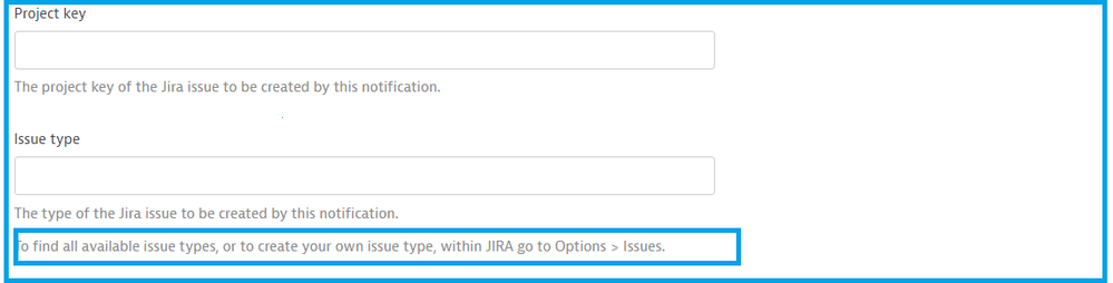

  • Both Project key, Issue Type can be created by the notification or provided by Jira team as well.

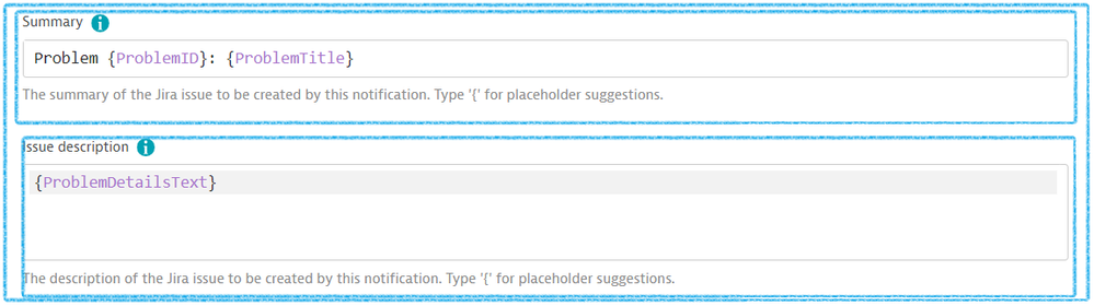

The below parameters can be customized as per the required payload contents

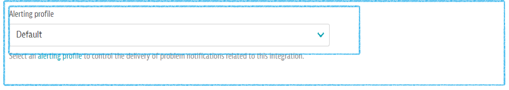

  • Select the alerting profile, if not selected the default will be used automatically.

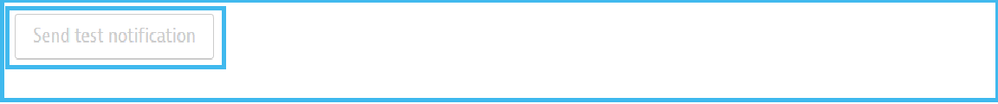

Final step : send test notification
