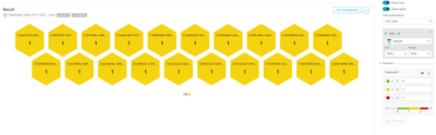

I have a custom metric (I am ingesting data points using the metrics API) which contains attributes such as: id, status, substatus, etc.
I am trying to visualize the data points of this metric with honeycomb. I am trying to plot all the ids with the specification:
- green: if status == "ok"
- yellow: if status == "warning" and substatus == "retry"
- red: if status == "failed" and substatus == "error"
The status and substatus are just dummy examples.
Is there a way to achieve this scenario with my metrics? I tried looking into calculated metrics, but I saw that it works only on the metrics ingested via OneAgent. Thus, I am stuck.
I appreciate any help on this 🙂

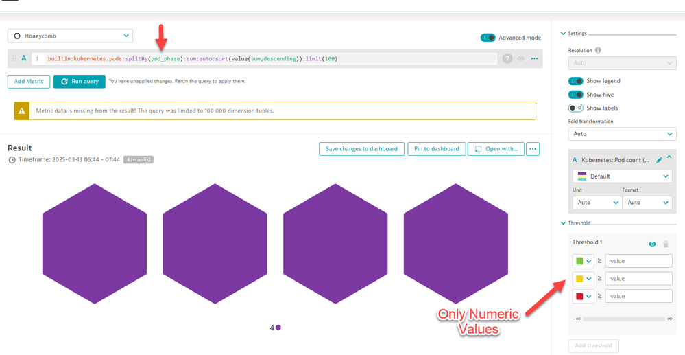

So with thresholds you will be stuck with using a numeric. Which means you cant call out Green = "Okay" Green would have to equal a Number. This goes for the other colors, here is an example using your design that closely aligns with Pod Phases:

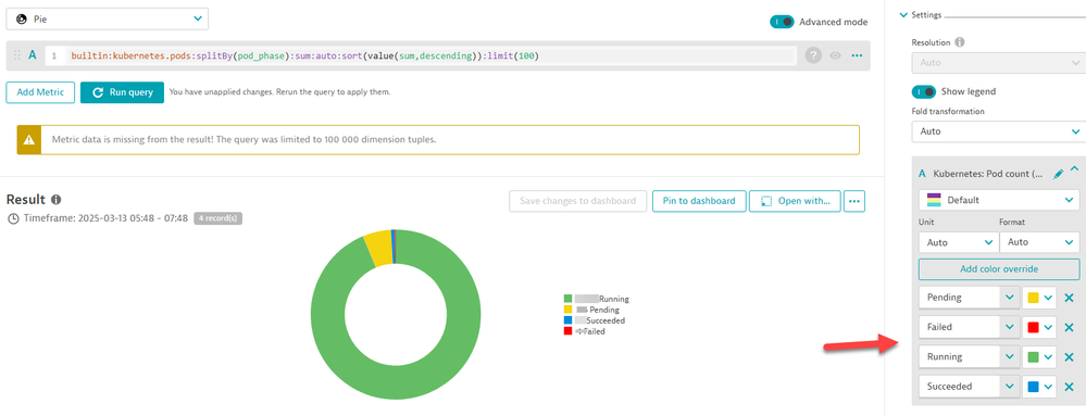

What we did for Pod Phases was use a Pie chart:
This allows us to call out the Phase which isn't a numeric value, and assign it a color.
I hope this helps 🙂

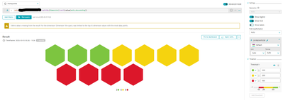

I wanted to plot it like this:
Do you know if there's any solution to this?

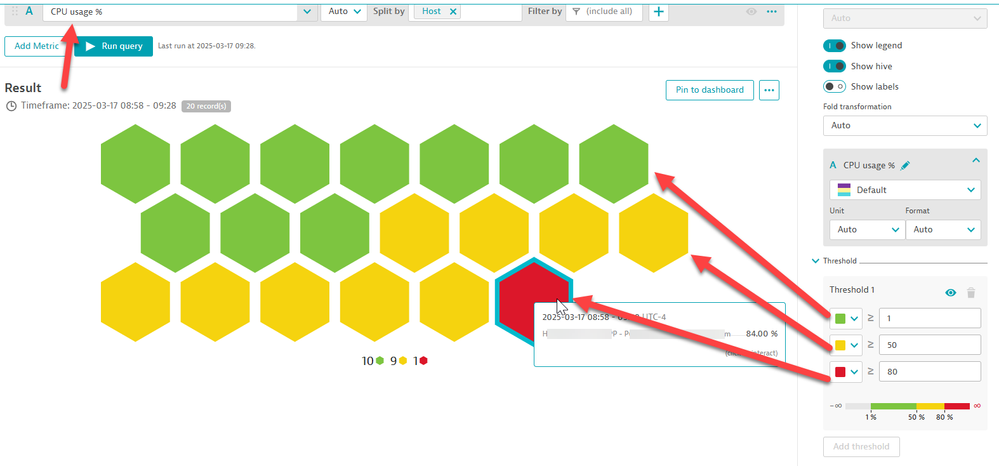

So I dont think you will get them into one Honeycomb overall. You might need to do a group in each tile. Split by Task ID, then filter on all tasks that have a status "OK" as green, Then make another tile that does the same thing but filters on the next task result and you can add in the desired color. The issue is the status isnt a number, If it was 1 as good, 2 as warning, 3 as bad then yes you could use a single honeycomb.
-Chad
