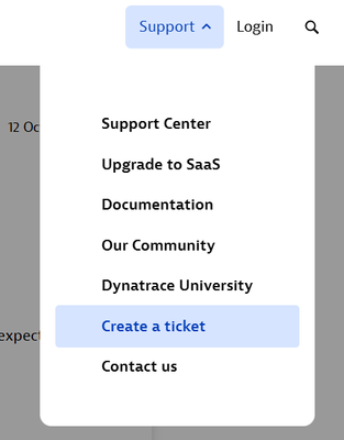

Please open a chat or support ticket so we can check this scenario. Thanks
You can open a support ticket by selecting Support > Create a ticket from the menu bar.

@HannahM where can i create a support ticket to dynatrace?
