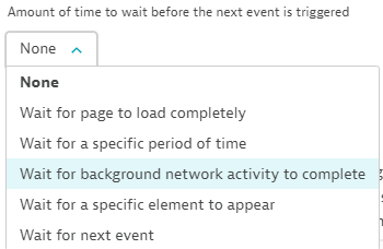

What did you select in"Amount of time to wait before the next event is triggered" field?
Maybe trying with the two last to options could be work. Have you tested it?

Hi Elena, thank you for responding. I tried your suggestion but that didn't work either, I think the way the page is set up DT isn't seeing DOM properly.
