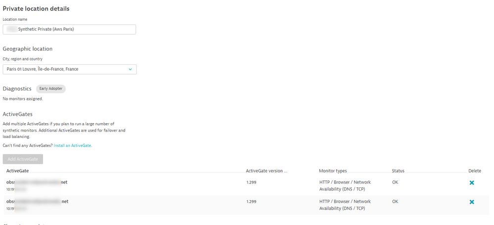

The 2 AG was added to a new private location but the Network Availability (ICMP) is missing in monitor Types :

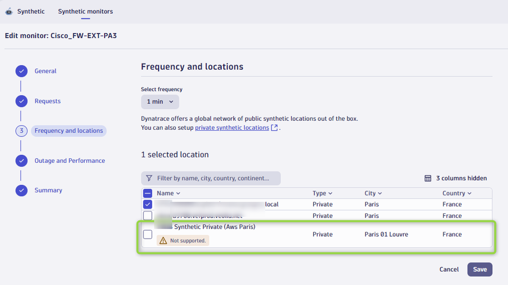

And I can't select this new private location to create ICMP NAM monitors :
"Not supported" exception with the following message : "Currently the location is not configured to execute this type of monitor."

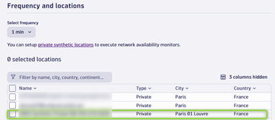

And after the restarting of vuc.service the "not supported" message disappears during nam creation at step "Frequency and locations" :

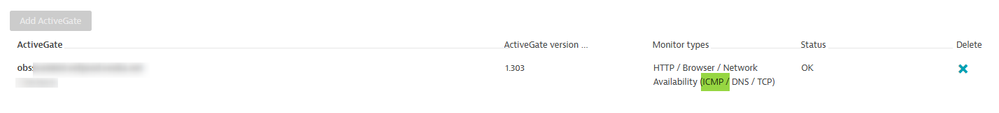

And ICMP appears as a monitor type :

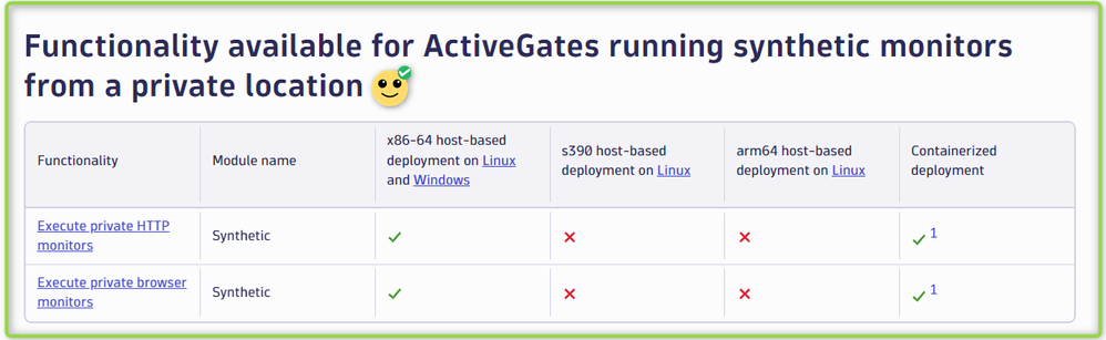

Hello @AurelienGravier
Can you validate the current setup against the below attached items:
(1)
(2)
Check The AG custom.properties file on Both AGs.
Hoping it adds value,
