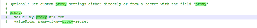

Hi @Enrico_F
have you checked customizing proxy configurations in Dynakube.yaml on the K8s cluster.
BR,
Peter.
08 Oct 2024 12:59 PM - edited 08 Oct 2024 01:01 PM
No, because

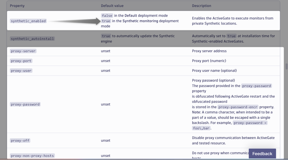

Hello @Enrico_F
You can check the attached configurations: https://docs.dynatrace.com/docs/shortlink/sgw-configure#synth_mod
Hoping it adds value.
BR,
Peter.
08 Oct 2024 02:01 PM - edited 08 Oct 2024 02:02 PM
Thanks. I'm already familiar with the ActivGate properties but IMO this is not really relevant here as my question is not specifically about the ActiveGate itself but rather about the synthetic (metric) adapter component that's required for auto-scaling containerized private locations on K8s.
08 Oct 2024 02:08 PM
Thanks @Enrico_F for feedback.
what about checking this section https://docs.dynatrace.com/docs/shortlink/sgw-proxy-authentication#advanced
Regards,
08 Oct 2024 02:48 PM
Already checked - none of that applies to the synthetic adapter component. But thanks anyway.
