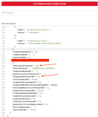

Hi @NicolasT ,
Thank you for your reply.
I tried several conditional expressions with reference to the screenshot above, for example:
response.getStatusCode() is Null
response.getStatusCode() != 200
response.getStatusCode() == 0
But nothing seems to work.
I'm guessing that maybe "healthStatusCode" would be considered a failure if it were a few specific items.
