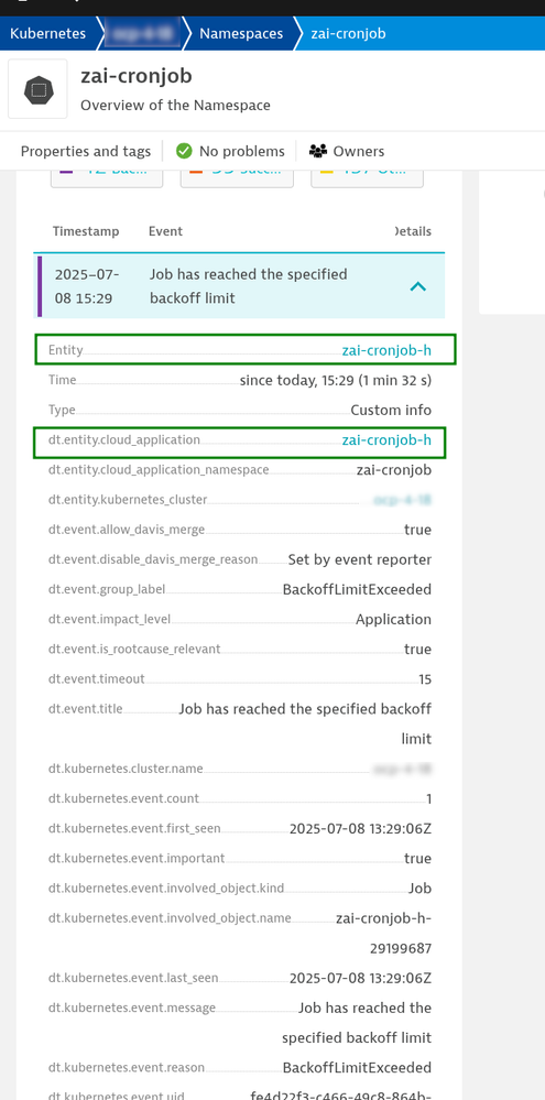

When a CronJob is configured with failedJobsHistoryLimit: 0, and the job fails after reaching the backoffLimit, the BackoffLimitExceeded event is triggered. However, the cloud-application is missing on the event, resulting in no problem being connected to the workload.
Problem
The failed job is not retained when failedJobsHistoryLimit is set to 0, preventing the problem from being connected to the workload.

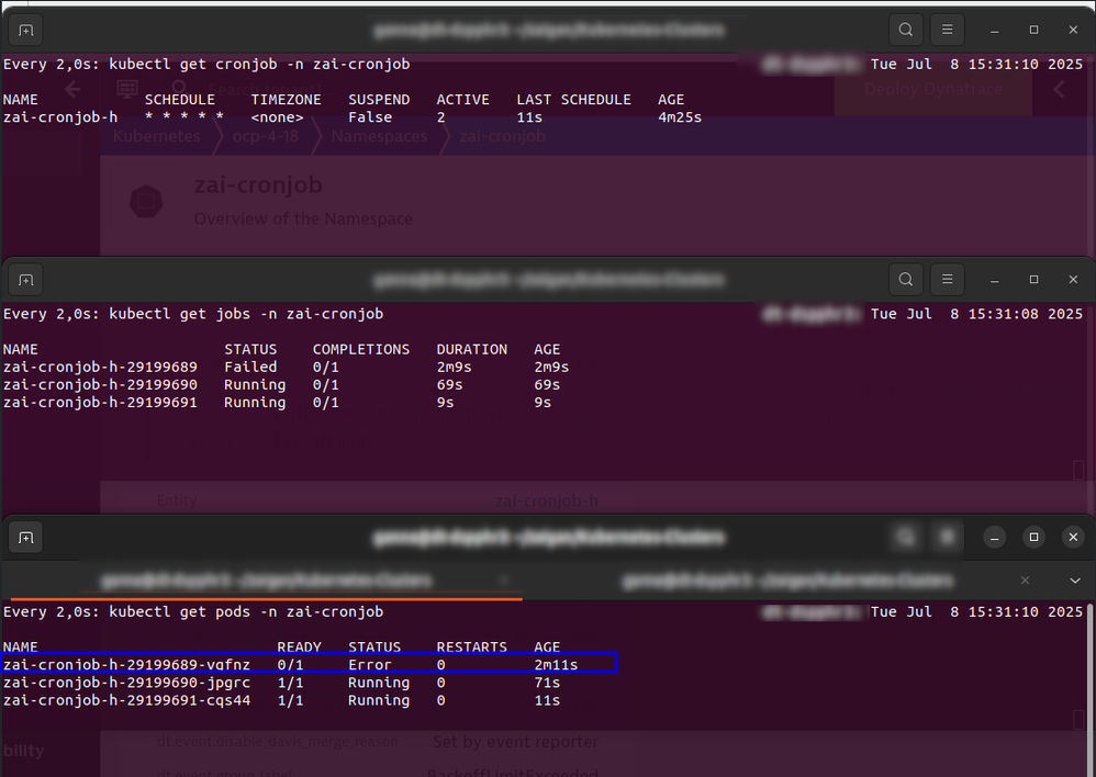

The above CronJob runs every minute and creates the following Kubernetes entities:
  • CronJobs
  • Jobs
  • Pods
Timeline: Relation Between CronJob, Job, and Pod

Below is an example timeline for a CronJob configured with failedJobsHistoryLimit: 0:
Entity Visibility Timeline
CronJob Runs indefinitely
Job 1 Visible from 12:00 to 12:02
Pod 1 Visible from 12:00 to 12:02
Job 2 Visible from 12:01 to 12:03
Pod 2 Visible from 12:01 to 12:03
Job 3 Visible from 12:02 to 12:04
Pod 3 Visible from 12:02 to 12:04

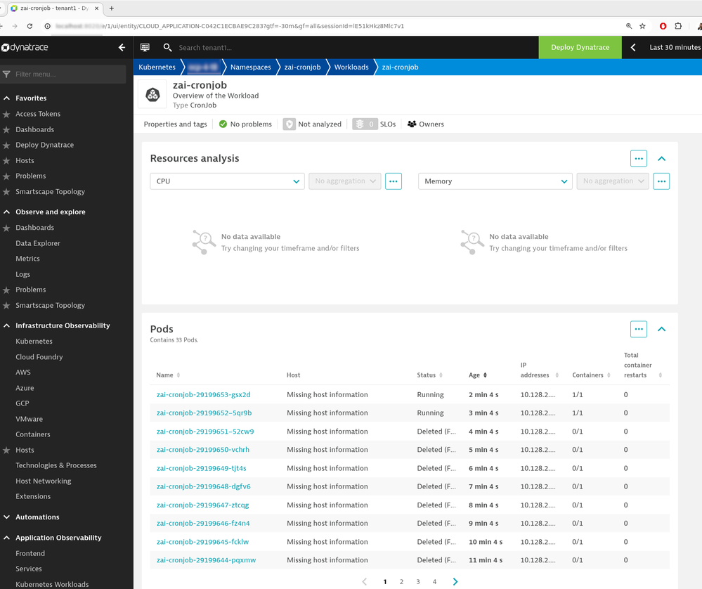

Visibility of CronJobs, Jobs, and Pods in Dynatrace
In Dynatrace, CronJobs and Pods are saved, but Jobs are not visible in the GUI. Jobs are only available at runtime as long as they are:
  1. Accessible via the Kubernetes API.
  2. Represented in Dynatrace as Controllers.
These Controllers are updated every minute to reflect the current cluster state.

Each job will trigger the BackoffLimitExceeded event exactly 2 minutes after it starts, because:
  1. The job runs for 120 seconds (sleep 120).
  2. It exits with code 1 (failure).
  3. With backoffLimit: 0, the job fails immediately without retries.

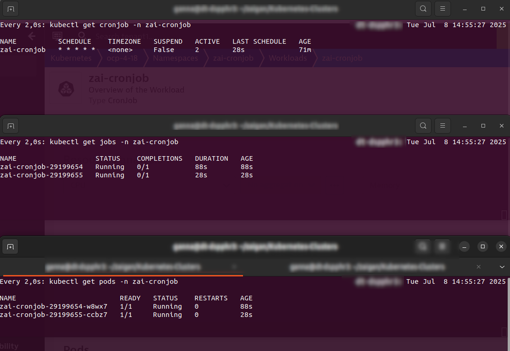

Impact of failedJobsHistoryLimit
Configuration Job Lifespan Pod Lifespan
failedJobsHistoryLimit: 0 Ends immediately after fail Ends immediately after fail
failedJobsHistoryLimit: 1 Retained until next failure Retained until next failure

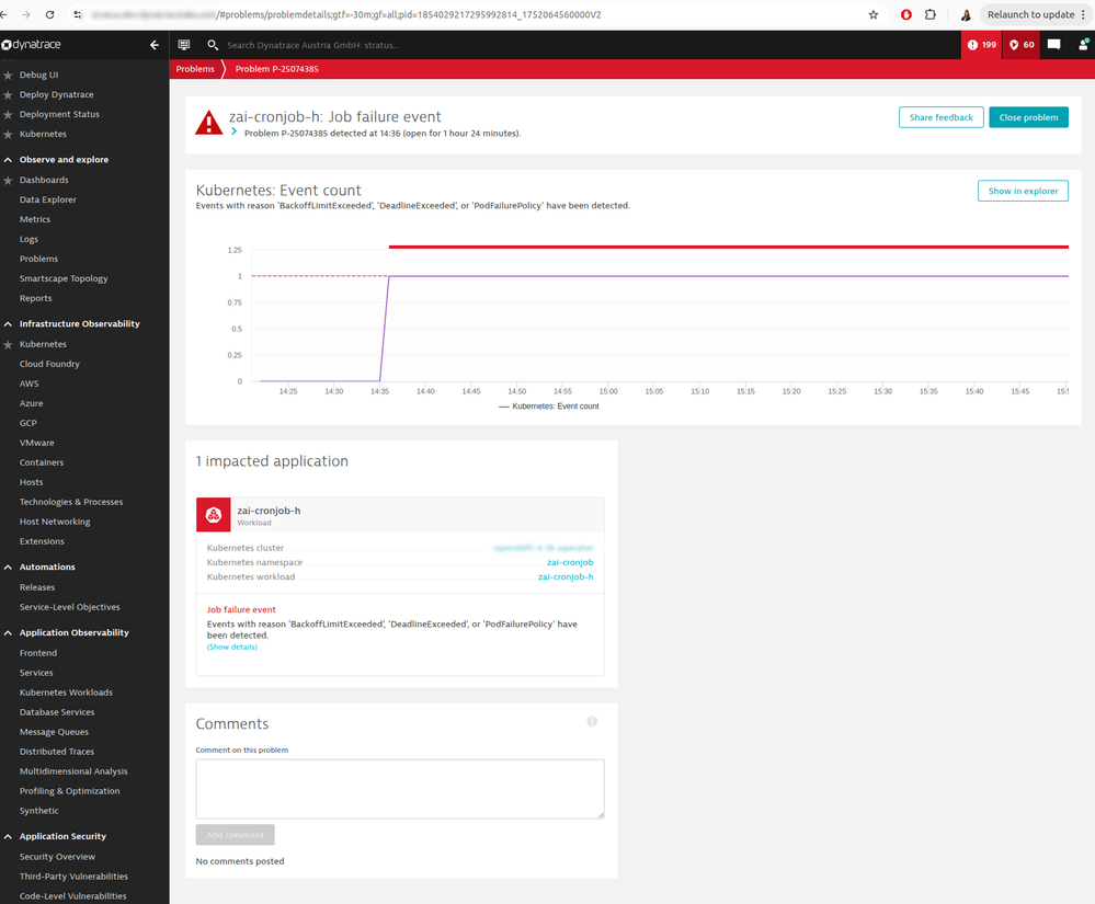

Result
With this configuration:
  • The failed job will be retained even after failure.
  • The BackoffLimitExceeded event will be associated with the workload.
  • A problem will be raised in Dynatrace, ensuring visibility and proper monitoring.
