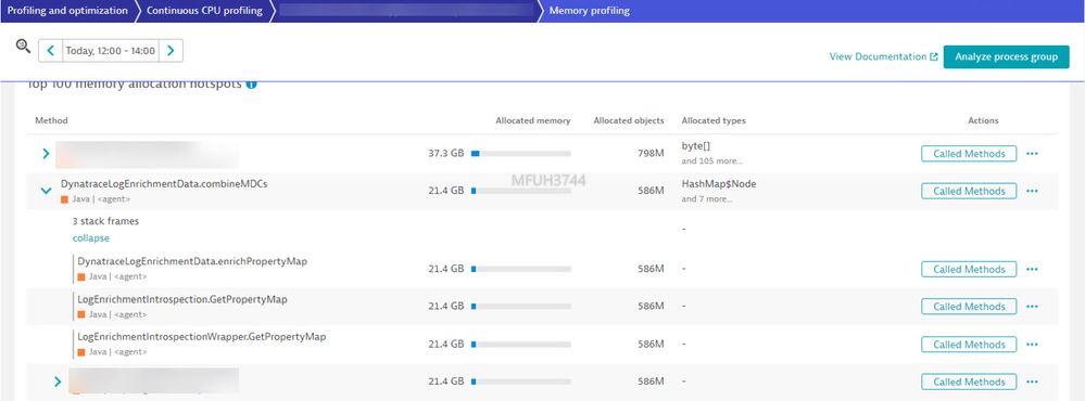

We can sometimes encounter high resource overhead because of the Dynatrace Object named “DynatraceLogEnrichmentData.combineMDCs”
This article will be helpful in understanding the regular working of the Log enrichment component. The technology involved is Java.
Below is the example screenshot from the Memory profiling page that shows the Dynatrace Object is taking up high memory:

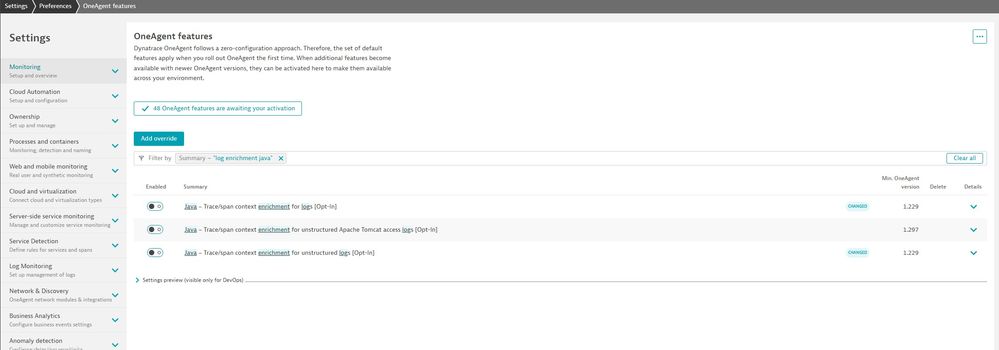

The "DynatraceLogEnrichmentData.combineMDCs" method can be safely disabled by turning-off the Log Enrichment OneAgent feature for Java from the settings page. Please refer to the screenshot below to make the changes via Global settings:
This can also be done via process group settings on a specific application process.
However, be mindful that this can be disabled only if the Application process does not use log monitoring.

The "Profiling and Optimization" page shows memory allocation. The Dynatrace objects/ methods seen in the above screenshot are freed again.
This is the so-called Java object churn. It is not a heap dump showing objects still in memory (memory leak).
It is correct that the method "DynatraceLogEnrichmentData.combineMDCs" is related to the log enrichment feature. The more logs are enriched, the more often it is called. However, all objects are garbage collected after the method is left.
We can conclude that this behavior is expected and that there will be no issues as long as the heap memory is stable.
