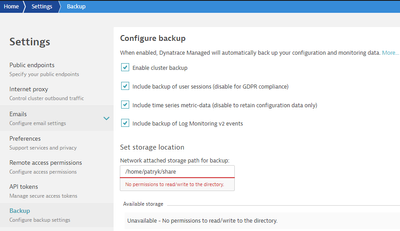

Problem 2 - "(...) Host 172.18.150.29: No permissions to write to the directory." or "No permissions to read/write to the directory."
Network path verification failed on some nodes. Error messages for each node are listed below. Host 172.18.150.29: No permissions to write to the directory.
What do these errors mean?​
  • It means that during the backup path test, a test file couldn't be created on the NFS storage due to missing/ insufficient permissions for the "dynatrace" user,
What can cause this error to appear?​
  • There is a missing directory on the storage compared to the path provided during the backup configuration
  • The directory is not owned by a "dynatrace" user (the user can be different and depends on the customer customization during Managed Cluster installation)
  • The "dynatrace" user doesn't have sufficient permissions to write/read from the NFS storage
  • The "dynatrace" user has different uid and gid across Managed Cluster nodes

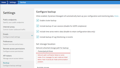

Problem 3 - "(...) Host 172.18.150.29: Node communication problem."
Network path verification failed on some nodes. Error messages for each node are listed below. Host 172.18.150.29: Node communication problem.
What does this error mean?​
  • It means that during the backup path test, communication issues were detected between Managed Cluster nodes

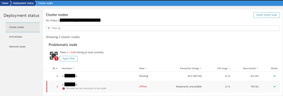

  • In most cases, one or more nodes are not communicating directly with the rest of the Managed Cluster nodes. Firewall issues, network issues, network overload, etc., can cause this.
  • There might be a situation where one of the Managed Cluster nodes is offline.
