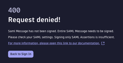

Saml Message has not been signed. Entire SAML Message needs to be signed.
This error indicates that there is either no signature in the SAML message or on the assertions were signed, not the whole SAML message. The whole message must be signed, because only then is the Service Provider confident that the message was not tampered with, hence our restriction.

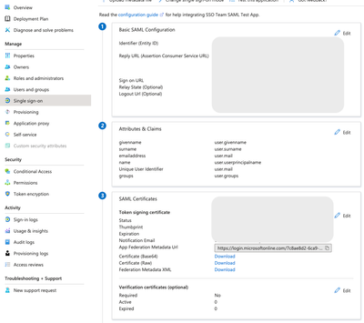

Navigate to the Azure Entra ID, and then to the SAML Enterprise Application you configured for Dynatrace. Then please open "Manage" -> "Single Sign-On" and choose "Edit" within the "SAML Certificates" section.

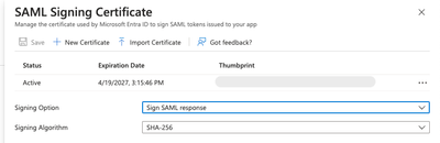

In the newly opened section, select the drop-down in "Signing option" and select: "Sign SAML Response"

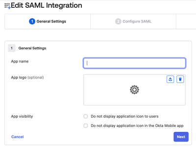

Within the SAML Application configured for Dynatrace, choose the "General" tab and scroll down to the "SAML Settings" section and click "Edit".

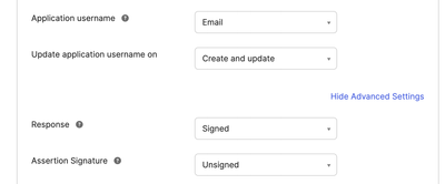

In the "SAML Settings" Section, scroll down and click "Show advanced settings" to see the signing options. The "Response" option should be set to "Signed", which will set whole SAML Message signing.

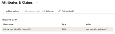

Navigate to the Azure Entra ID, to the SAML Enterprise Application that you have configured for Dynatrace. Then please open "Manage" -> "Single Sign-On" and choose "Edit" within the "Attributes & Claims" section.

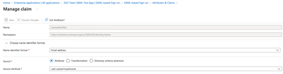

Then, make sure there is a Unique User Identifier (Name ID) claim.
Upon clicking on the claim, check that the Name identifier format is set to Email Address.

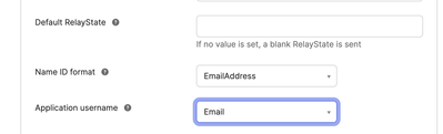

Please make sure the "Name ID format" is set to "EmailAddress". The "Application username" should in most cases be set to "Email", especially if you use a different login as the Okta Username.

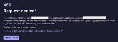

Your IdP returned different user {0} than user {1} you entered into Dynatrace.
The NameID claim (described above) is used in Dynatrace SSO to match the user login in the IdP to the one entered in the login field and they have to match.
Resolution:

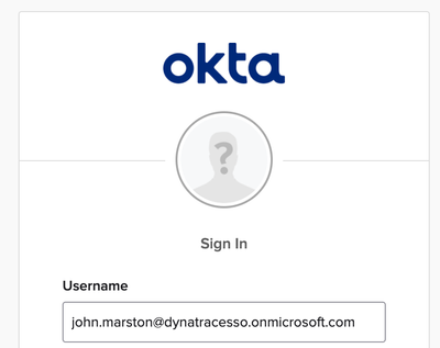

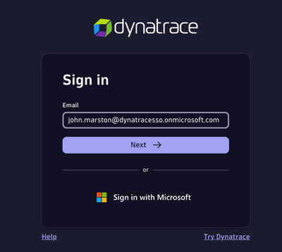

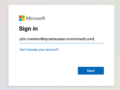

First and foremost, please verify that the user currently logged into Dynatrace or the one which you input in the login field in Dynatrace SSO match:

On top of the settings from the paragraphs above about NameID, please make sure that the parameter you use for the Source attribute e.g. user.userprincipalname :

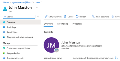

is actually the same as the value for the user currently attempting to log in:

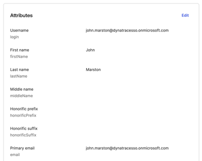

If you are using the "Application username" as "Email" in the "SAML Settings" (see how to reach these settings above), then within the user's profile, please make sure the "Primary email" value is the same as was entered in the Dynatrace SSO login field.
