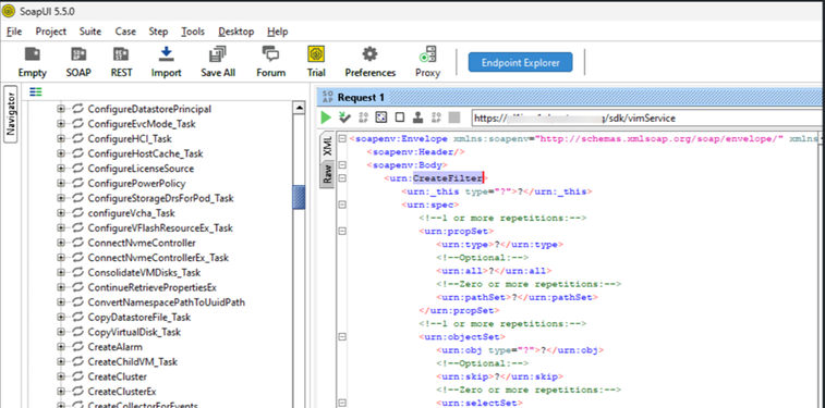

4. Another approach to verify whether the connection is functioning as expected is to use the SOAP UI tool. This application provides a straightforward way to determine if connectivity to the vCenter is established. For example, by installing SoapUI locally on your system or server, you can attempt to connect to vCenter using the same URL (https://172.x.x.x/sdk/vimService.wsdl). Once connected, you may execute typical service operations, such as QueryHostsCountVMs, which triggers the CreateFilter operation within the vimService. This method allows you to observe whether the connection is successful and whether operations can be performed.
