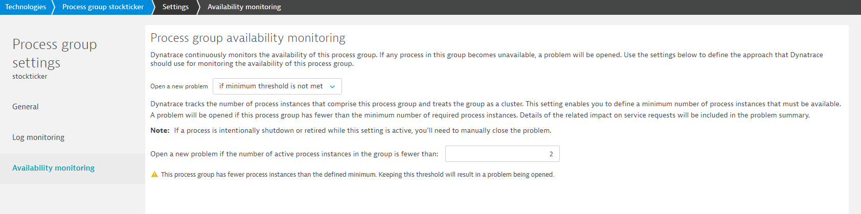

There is a built in problem pattern implemented that you can configure. Just go to the process groups settings screen and configure the minimum number of process that should run.
The metric you chose for your custom alert is the wrong one as it represents the number of processes within a 'Process Group Instance', which has a different semantic than what you would like to achieve.

Hi Wolfgang,
Thanks for you answer. If I understand well, the setting you propose works on the number of process group instances. So I should set it to 2 as I have two hosts.
If I want to be sure that I have got 2 worker processes per process group instance, I should also keep my custom alert in order to be sure that I have my 4 actives processes.
Am I right?

First one is correct, second part I am not really sure, never tried that for that use-case.

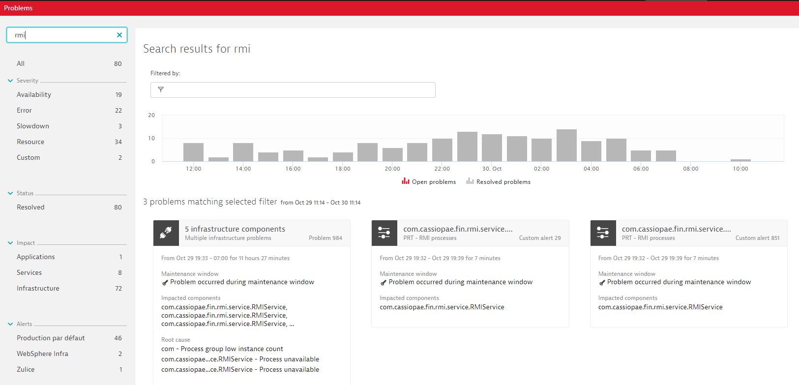

Hi Wolfgang,
Looks like the two rules work.
Last night, I got alerts on the two instances and on the processes number per instance.
Should be OK now.
Thanks again for your help.
