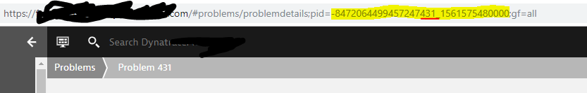

The problem card numbers in Dynatrace go from 1-999, would anyone know if it would be possible to increase this so that problem cards numbers are not reused as often?
26 Jun 2019 08:58 PM
Only a set 3 digits of a problem are actually displayed within the UI. The full problem ID is much longer and you can see it both in the URL for the page and if you poll the problems through the API. This is just for making the UI and referring to recent problems a bit easier - any links or programmatic access to the API uses the full problem ID.
