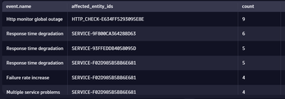

Hello!
Searching for help with the following, i'm relatively new using DQL. I have the following code, what i want is to display the entity names on the affected_entity_ids row, not the id, so far i have tried to change the affected_entity for dt.entity values but no luck so far, any ideas how i could change the values on that field?
Code:
fetch events, from: timestamp(year:2023,month:10,day:16,hour:0,minute:0,second:0), to: timestamp(year:2023,month:10,day:16,hour:23,minute:59,second:0)
| filter event.kind == "DAVIS_PROBLEM"
|expand event.name
|summarize by:{event.name,affected_entity_ids}, count = countDistinct(display_id)
|sort count, direction:"descending"
Result:

I have something figured out for now, it might not be optimal but for now it's working, my only issue now is that the results are not grouping by event name as it used to, but for now it works for the purpose i intend to use it.
