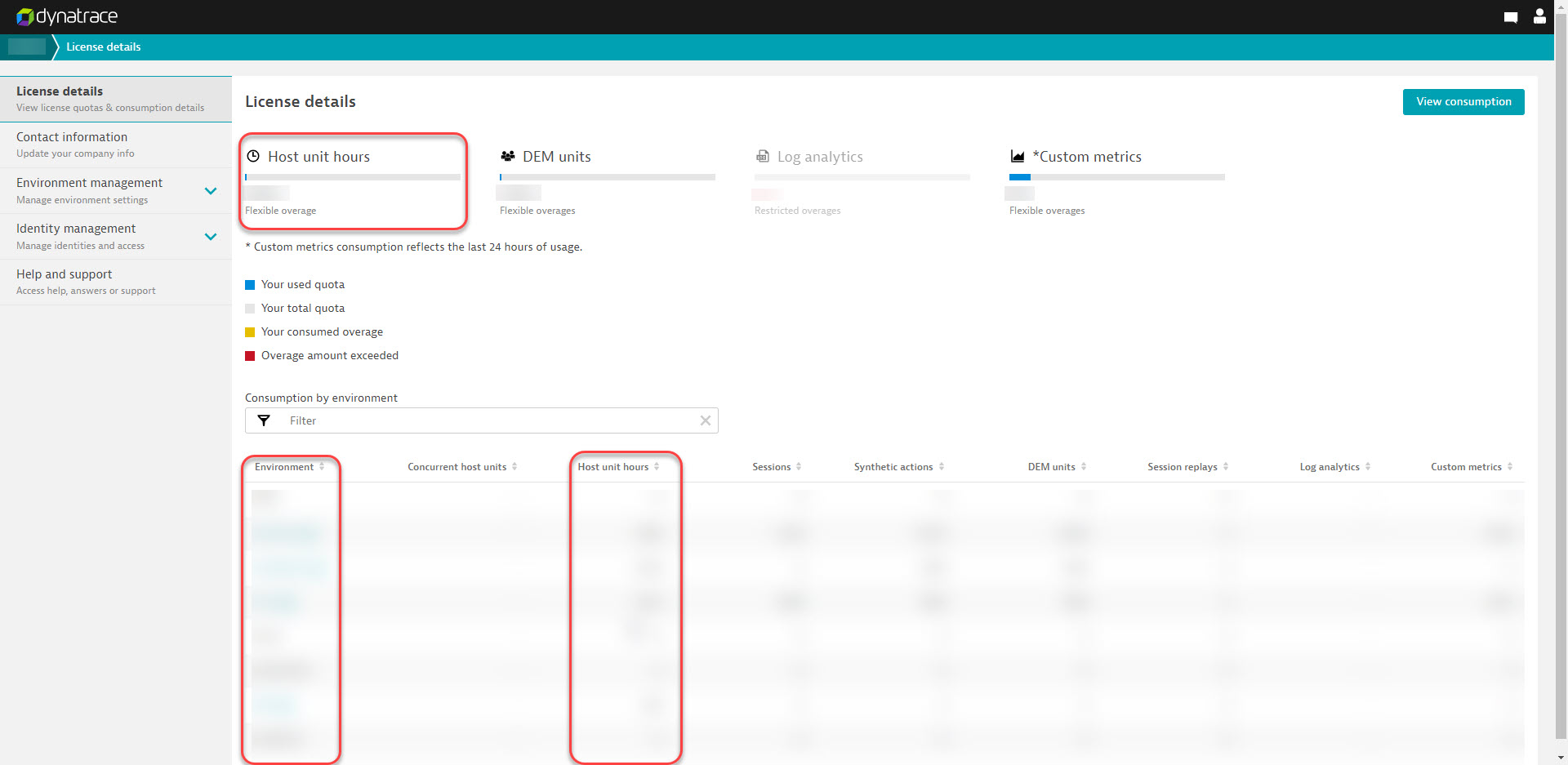

Hello everyone. This use to be possible via the UI and was quite easy, but now you will need to resort to the Environment API for this data to be pulled.
If you are a SAS customer you can also Navigate to the Cluster page, just like in Managed, and see the overall consumption as well as per the environment. This will show as host unit hours or host units - depending on you contract.

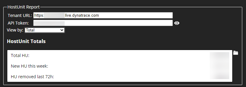

Hi, the tool is first doing an API call to
https://*******.live.dynatrace.com/api/v1/entity/infrastructure/hosts?includeDetails=true
Which returns a JSON doc with lots of fields but the one you care about is consumedHostUnits:
  "consumedHostUnits": 0.25
From there, the tool is performing this logic to calculate the different figures.
If you'd like Dynatrace to build this automated report for you, I'd advise speaking to your local Dynatrace Services team lead who will be able to assist.
