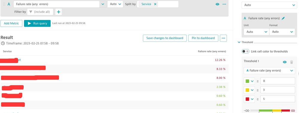

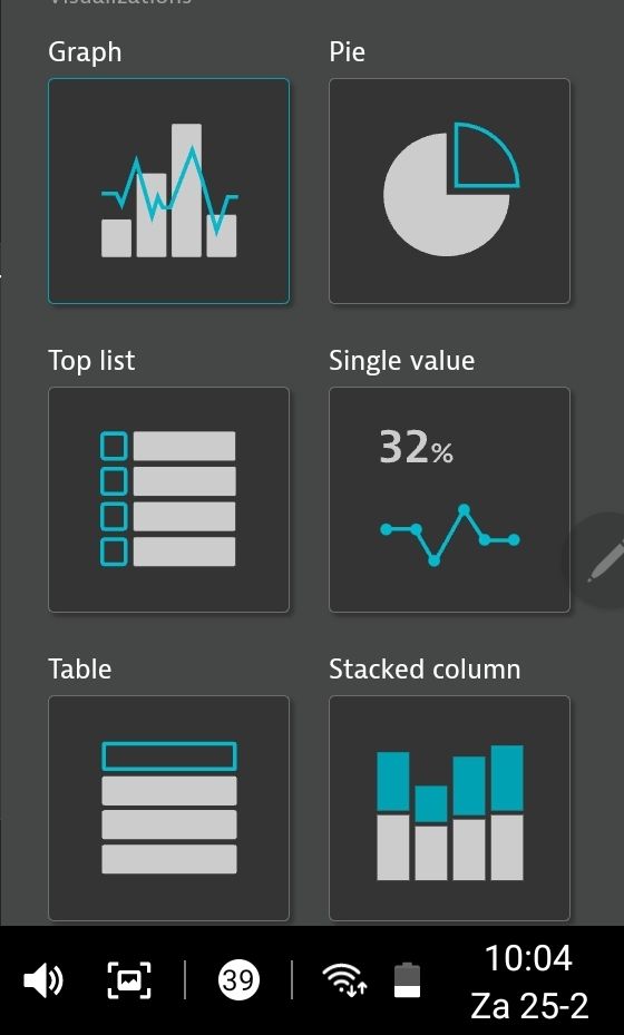

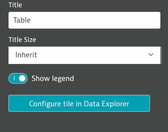

Hi Selvam_Sekar, apologies but could you expand a little further. Is what you're suggesting done via a dashboard and if so what tile should i be using. Again I want an indicator to show me any problems where failure rate is above a certain threshold. Hopefully via a dashboard tile. I really appreciate any further advice on this.
He is using the Data Explorer to get these metrics. From the data explorer you can use "Pin to Dashboard" to get it on a dashboard. Another option is to use the Dashboard Tiles (f.e. Graph or Table). While configuring this tile you can go to the Data Explorer and use all metrics available in Dynatrace.
If you want a list with requests that have a high failure rate you could use metric: Failure rate (any) and then work with the colors in the dashboard to give everything higher than 5% a red color in a Table tile:
