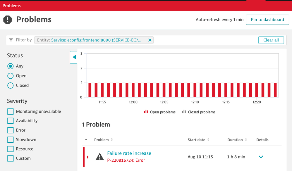

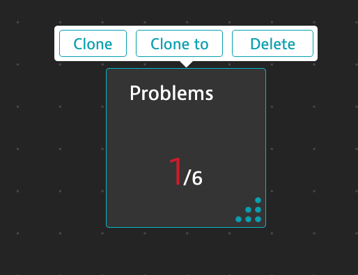

You can add a problem widget for that specific service using filters in the Problems page, and then use the Pin to Dashboard button.
Does it fits for you?
shakib
Guide
Nice. Thanks!
