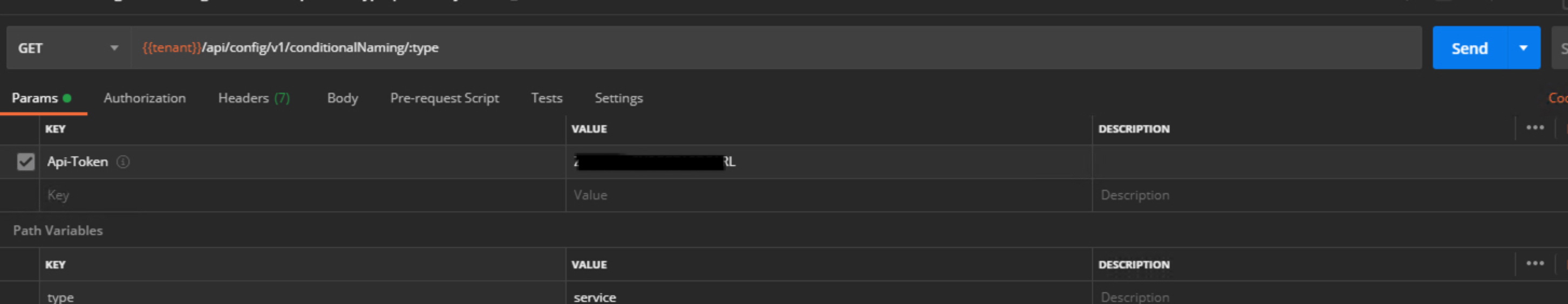

As Alonso mentioned, I can do the GET to pull all the services and their IDs using conditionalNaming API {{tenant}}/api/config/v1/conditionalNaming/:type

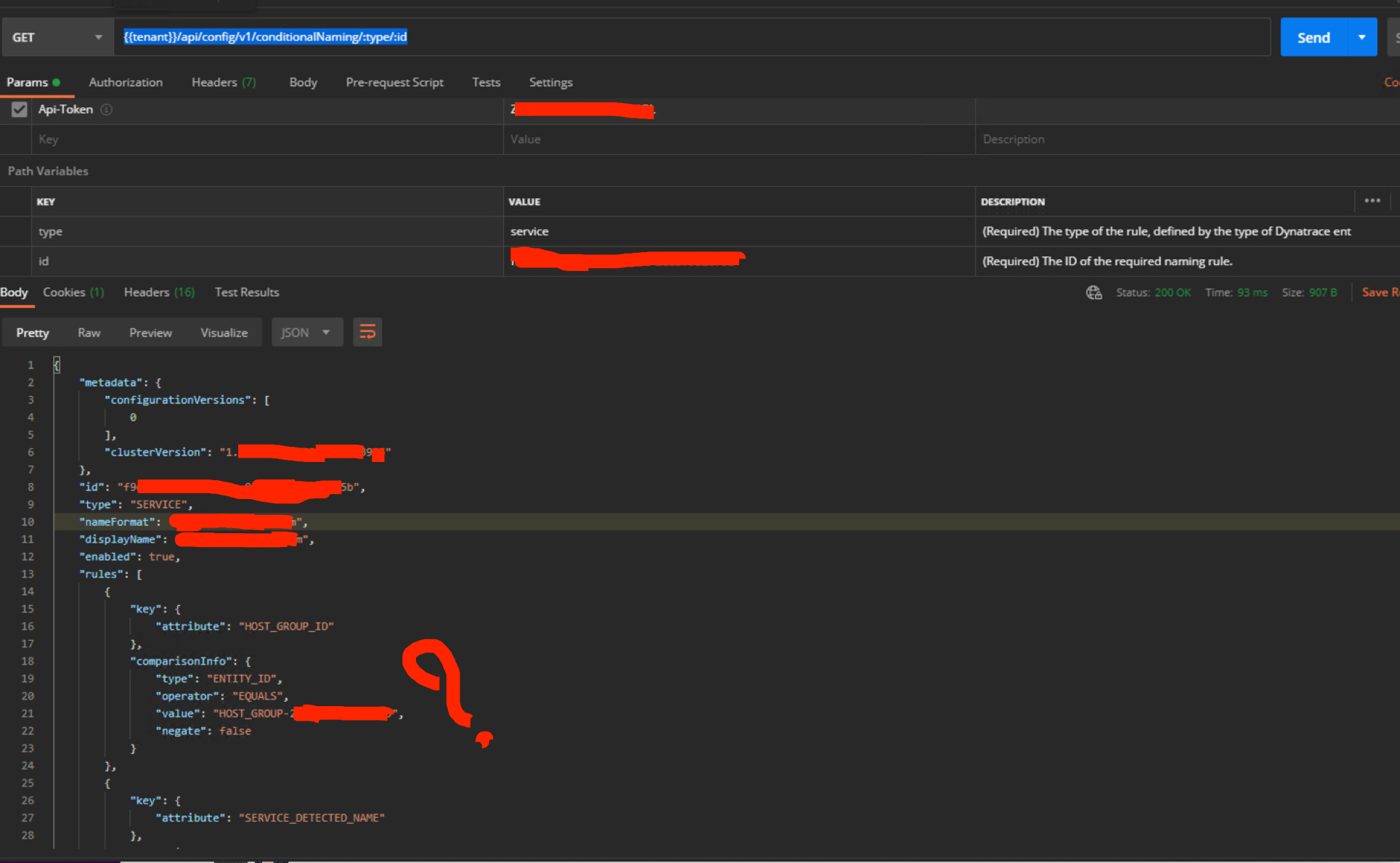

now the question is, to do POST this in new environment where I want to modify and create as a new rule, I am not able to find how to GET the HOST_GROUP_ID values for new environment so that I can modify the Payload and POST to the new environment to create the rule(s)
fyi, this is the payload I am trying to POST in new Environment to get the rule created. Not sure how to get the HOST_GROUP_ID values of new Environment. if I get them, then should be easy to create. Please suggest.

Here is the solution:
  1. Using ConditionalNaming rule API GET the Services and their IDs’ where all the Service naming rules are created {{tenant}}/api/config/v1/conditionalNaming/:type
  2. GET the properties of each Id {{tenant}}/api/config/v1/conditionalNaming/:type/:id
  3. GET the host group ID of the host group of the the enviornment where you are planning to create the rule using API {{tenant}}/api/v1/entity/infrastructure/hosts
  4. Take the meId from #3, modify the #2 response and POST the payload using {{tenant}}/api/config/v1/conditionalNaming/:type
