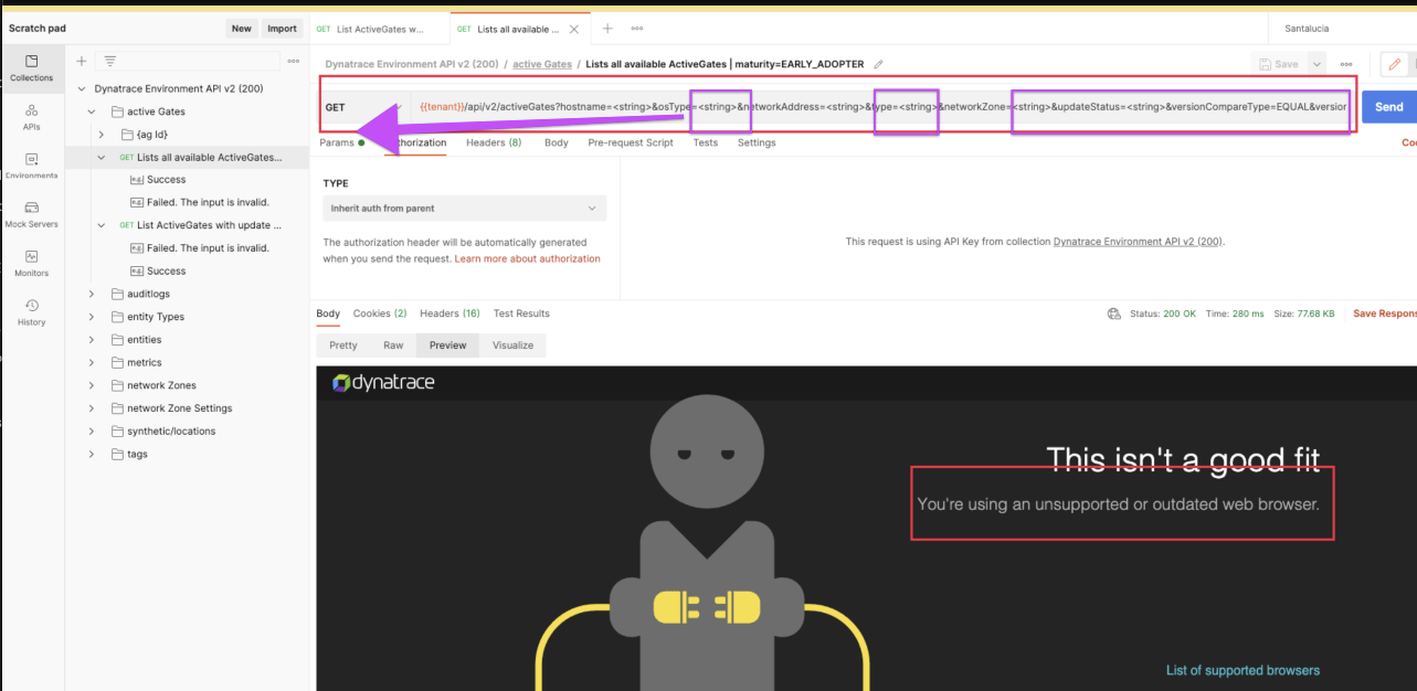

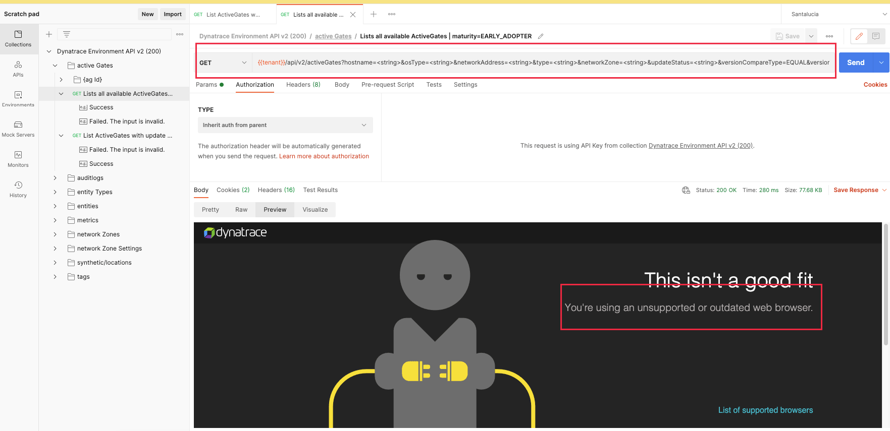

I got an error using Postman, I hope you handled it before and know how to solve it. The thing is that I'm trying to connect the latest version of Postman (8.0.4) using Dynatrace GitHub Collections (https://github.com/sergiohinojosa/dynatrace-api-postman-collections) to Dynatrace API. I have created env variables to resolve the DT tenant and API-Token. The problem comes when I run the request, I am getting the message "Unsupported web browser ":

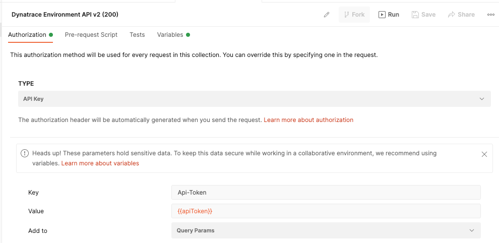

It guess it's an issue with embedded Web browser from Postman. The Authorization method that I'm using is API Key:

I guess you need to update how you authenticate with the token. It should look rather like this:

I have not tried with the new Postman version but it should work (suppouse). Unless the collections are not compatible anymore. The collections are being generated from our API spec. I have not updated them for a while now, so you might not have a lot of endpoints (I'll add it to my todo list).
Can you post the request from the log console of postman? with the info (except the tenant and token of course)?
As a side note: Regarding passing the Token, both methods are accepted. You can pass it as a Header or a Query parameter. Recommended is always as a header parameter. The collection has it as query since sometimes is needed to access Dynatrace behind reverse-proxyy. A reverse-proxy normally strips down the header, and the query won't be stripped down. On the down side, a query parameter might be stored on the audit log of the webserver, so something to keep in mind.
https://www.dynatrace.com/support/help/dynatrace-api/basics/dynatrace-api-authentication/?http-heade...

@Alberto D. I just updated my postman and the collections are compatible with the version 8.0.4. By taking a closer look at your request I notice that the parameters are not setted. Try again by either unselecting them or setting a value. THe genration of the collection generates not only the endpoints but some documentation and the parameters.

I have run an End-Point without parameters and I'm getting the same error:
{tenant}}/api/v2/networkZones

The authorization method is based on Header and API-key and API-Token is correctly set:
The thing is that I am still getting the same error:
