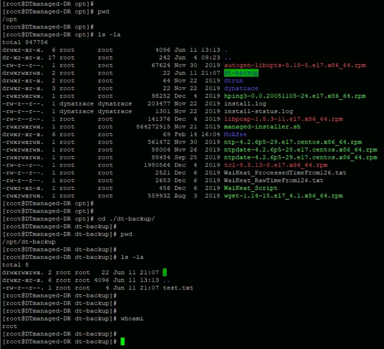

My backup directory is /opt/dt-backup/
Below is the output:

As I mentioned... it should be owned by dynatrace user.
