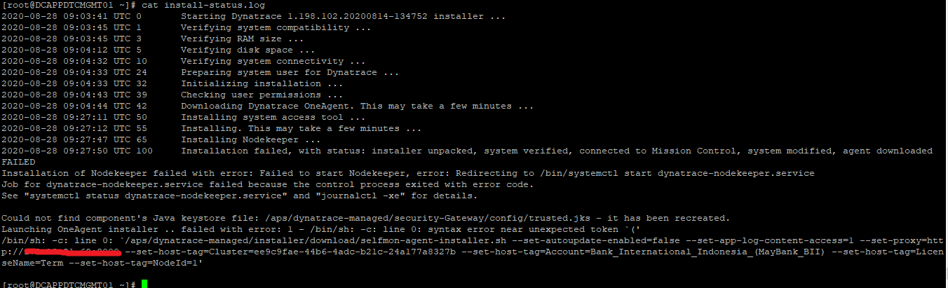

I attached log

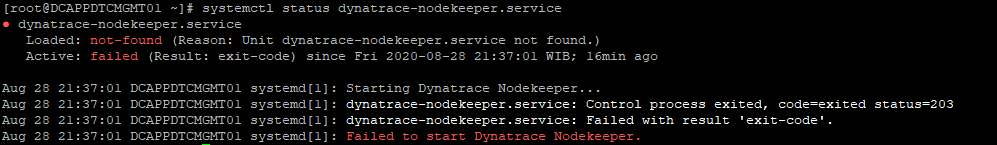

This is capture from "systemctl status dynatrace-nodekeeper.service"
