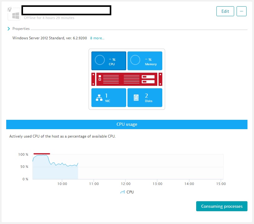

I wanted to clear my concept of infrastructure monitoring. Today, I noticed that one of the servers went offline at 10:30 AM and came back at 10:54 AM.
In the hosts' dashboard, one was grayed-out and other was active.
Same Host
The downtime/offline time was 24 minutes but we can see that the offline time of the unavailable host keeps increasing even though the server is available.
Offline State
Also, there is no connectivity on the graph between offline and uptime with the unavailable time.
Online State

If you have new host not old one back active this means that agent was reinstalled all even host recreated. We have the same issue with AWS deployments where hosts are destroyed and started again. Right now there is no option for linking them for continuous data set.
Data are missing because during blank there was no monitoring at all.

If this was only restart you should see the same host online. There is special ID generated on host after installing agent. This is why after each restart data are sent to the same host tab in dynatrace.
Sebastian

Host id is always in URL when you go to host page.

URL 🙂 not properties. There is ID of entity that you are looking at.

I can see that both hosts (offline and online) have different IDs. So can I assume that this was a restoration of the VM instead of a restart?
  • #newhosts/hostdetails;id=HOST-A9A81E6F3C836130;
  • #newhosts/hostdetails;id=HOST-39D1C4FC40ACC8D8;

You're correct 🙂 In general if you will see the same host as new instance it always means that new ID was created. This happen mostly during destroy and recreate of host.
