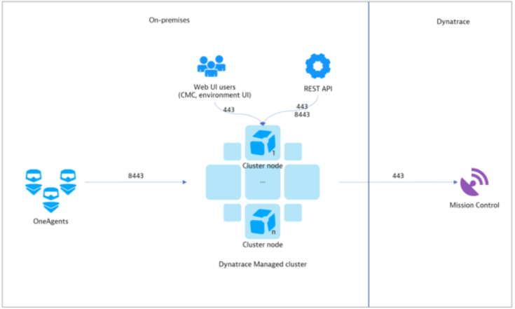

I would like to install 3 Dynatrace managed servers (3 instances running on different machines) on 3 different virtual machines without setting up ActiveGate in the environment.
Which cluster node do I have to download OneAgent installer from?
How will OneAgent communicate with 3 Dynatrace managed servers?
Which node will OneAgents communicate with?

You can download it from any of them or really you'll just be using the dns name for you cluster (it ships with a xxxxx.dynatrace-managed.com one created for you) which should cover all of them. The OneAgent data is distributed among the nodes in the cluster automatically, at any given point in time they will be communicating with one of them but if there is an issue with one node they will fail over to other remaining nodes.
