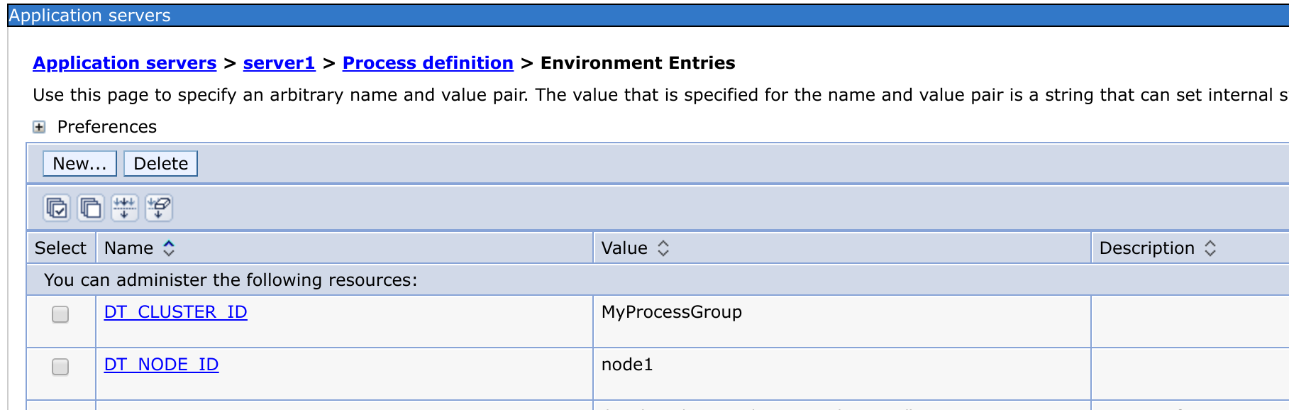

Actually the best method here is to utilize the DT_CLUSTER_ID and DT_NODE_ID environment variables for those WebSphere instances and not dealing with the process group detection rules at all.
Just set your desired values for the server process in WAS admin console in :
Application servers > <server > Process definition > Environment Entries:
And fully restart the WAS process.
From the example above, your WAS will be a member of MyProcessGroup and will be identified as node1.
