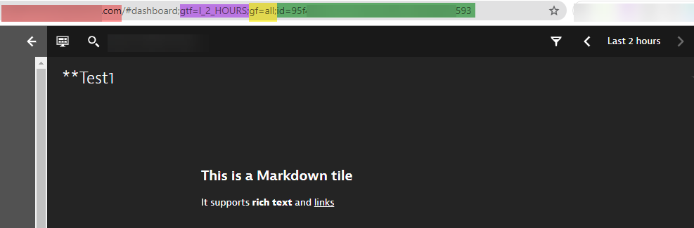

So how do we do this? First lets get an understanding of the dashboard URLs. Here is a sample one we will dissect:
From the Image above we can determine the following:
RED: Your Environment ID (Managed/SaaS Customers)
Purple: The selected Time Frame - Currently set as the last 2 hours
Yellow: The Management Zone Selected - In this case the filter = All
Green: The Dashboard ID of the dashboard you are currently on
So as you can see, we are on a Test Dashboard and we put a mark down tile on it. now that we know how to read the Dashboard URLs, lets go ahead and link our Test2 dashboard to the Test 1 dashboard via the Markdown Tile.
